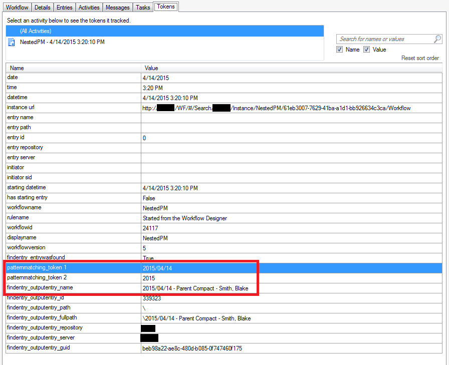

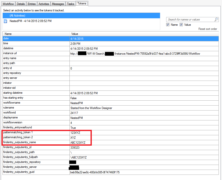

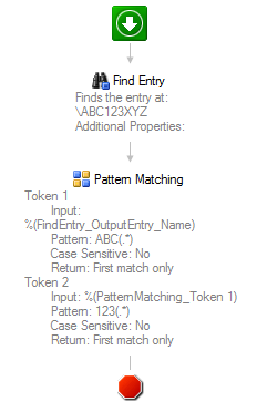

I ran a generic test and wasn't able to recreate the issue. See below:
replied on April 14, 2015 • Show version history
I have changed the workflow so I could get it up and going, but really it was pretty similar to the one below, with the exception that it was setting the input value from another pattern matching token.

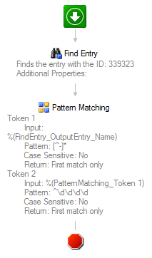

Here is what the token setup of the one that was feeding the one above looks like:
So you are getting the "Form Date" based off of the entry name using the pattern
and then you are getting the "Form Year" from the "Form Date" using the pattern
^\d\d\d\d
Can you provide a sample entry name that we can test with?
2015/04/14 - Parent Compact - Smith, Blake
I'm not able to recreate the issue in Workflow 9.2.0
