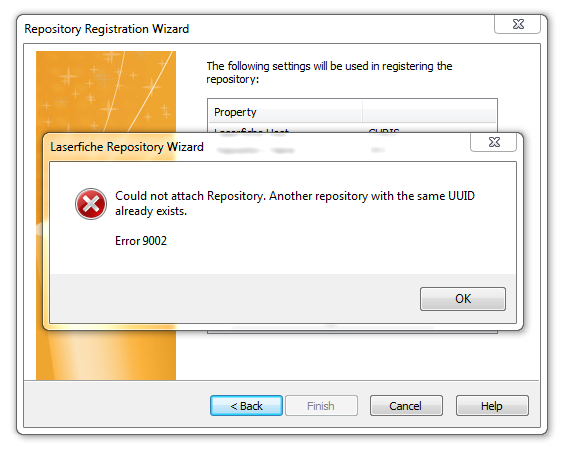

I've also tried copying the database but when I try to register the repository I get the error:-
Looking in the DB options table I can see the UUID matches whats in the registry. How can I change the UUID so I can use this database?

In the mean time there's software from Laserfiche to update the UUID.
https://support.laserfiche.com/KB/1012907

I have tried running the UUID utility on the customers DB. However it is very large and it crashes after about 15 hours. Is there a SQL script I can run that will delete all documents but leave the folders present? This would dramatically shrink the DB size (and what we are trying to do also is have a document free repository just the folders and access rights left behind!).
