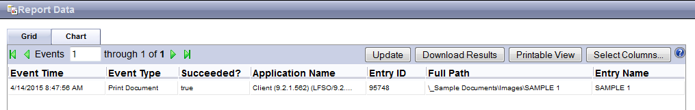

What version of the Laserfiche Server and Audit Trail are being used? How is the audit report being built? I'm testing in 9.2.1 and just have a report that is only looking at "Print Document" events with no other filters and this is what I see:
Note that if the customer is using Audit Trail 9.1 then please have them upgrade to Audit Trail 9.2. You'll also need to re-import the audit data into the audit database. The easiest way to do that is to just delete the audit database and then recreate it by going through the database and date range configurations in the Audit Trail Configuration site. There was an issue in Audit Trail 9.1 where if "Reasons" were configured for export/print events, then Audit Trail 9.1 wasn't able to completely import the entry data for those events.
replied on April 15, 2015
Alex I tested this out on my end as well and the entry data was recorded. On the customers end the Entry ID, Full Path, Entry Name and other items are missing. The only thing that comes up is the Event Type, Event Time, Succeeded?, Application Name, and a few other items. I have checked under the everyone group for auditing and everything was checked off correctly. Would you happen to have any ideas as to why no data was recorded for those logs? The current version that is being used is 9.0.2.728
