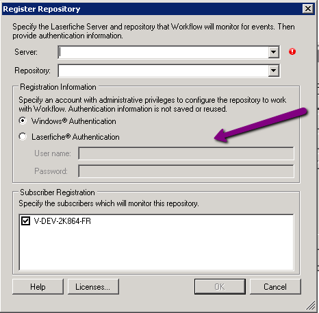

I've started installing my demo kit, and when I go into the Workflow Config Mgr, I get a 9013 "Access denied" error when I try to add a repository. The error comes at the end after I have seen the server and selected the repository. The Workflow Server and Subscriber have been configured ok. It's the Monitored repositories that is a problem.
Anyone know how to fix this problem??

You need to log in with a user with the Manage Trustees privilege so Workflow can configure the account for the Subscriber.
replied on April 8, 2015
Thanks for your response Miruna, I'm very new at this. So even though I am installing everything on localhost I need to log in with a different user (with appropriate credentials)? How do I go about doing so?
You're logging in to Laserfiche there. It sounds like you left it on "Windows Authentication" and your Windows user does not have enough rights in Laserfiche. A more powerful Laserfiche user, like "admin", can be used.
Thank you very much Marina. That worked!!!!! Much appreciated
