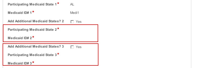

We are using 9.2.1.1069 also. We tried the code you mentioned, but the hidden fields still show up in the repository. (Please see screenshot).
Below is the snippet of the code we are using.
            PranetLI.nextAll('li:[attr=XXXXX]').show()
        else
            PranetLI.nextAll('li:[attr=XXXXX]').hide();

replied on April 17, 2015 Show version history
Did you encounter this issue when saving form "Without Pagination - Contract Form 2" to repository? I tried the process and found that subitems of "Question" under "Disclosure Section" which should be hidden would show up in file saved to repository.
If that is the case, the issue is that after form is submitted it would become read-only, and no element could be found using $("div.cf-section-block:last div.kx-repeatable div.form-q").
Instead, you can use $("div.cf-section-block:last div.kx-repeatable ul") when calling DisplayProviderSectionQuestions and DisplayProviderSectionSubItems on document ready function. In my test changing these two functions makes the fields hidden as expected in file saved in repository.

replied on April 24, 2015
Thanks Rui. We tried the recommendation and it worked.
Appreciate your help.
