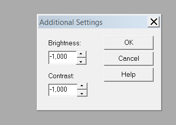

Then I tried checking the bringhtness/contrast settings on the problem scanner, both of which are set at -1000 under File > Scan Settings (see attached pic). First, these settings are identical to the other end users, so probably not the issue. But I decided to try raising the brightness to see if it made any difference. However, when I change the setting and then open the File > Scan Settings window again, the brightness is right back to -1000.

Sounds like there is an issue with the scanner. I am not familiar with your scanner but I know others that if the bulb is starting to go bad can cause darkness. I would suggest getting it looked at. Another test  I would do first is put that scanner onto someone else's workstation where their scanner scans good. If you get the same dark result then it is a scanner issue. If the pages come out looking good then I would uninstall the driver and reinstall to see if that fixes the issue. Changing settings may fix the issue but it is only making the real issue what ever that may be.

I had two users with the same model scanner swap scanners. Both scanners were detected as new devices by windows and were reinstalled successfully. Both scanners had to be reselected as a scan source in LF client. After that, scan jobs look normal on both scanners.
I guess there was an issue with the driver.
