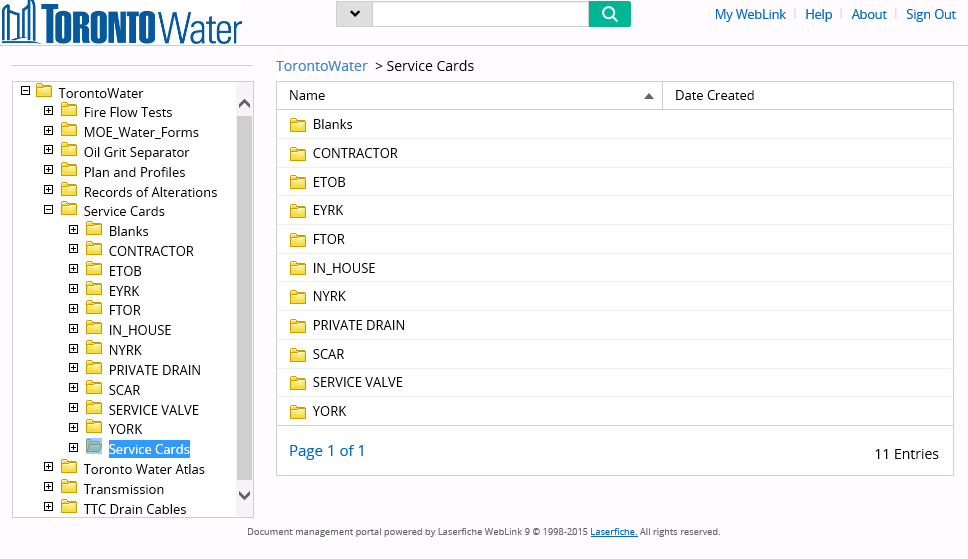

Weblink 9 Folder tree missing ?
asked on March 26, 2015
I am trying to add Folder tree option on the left panel, and was using this code before <weblink:FolderTree  ID="TheFolderTree" runat="server" /> , that worked but I am not sure if this control still exists  on Weblink 9 ? And is there a download for the solution file for Weblink 9 or its only available to those who have SDK package ?

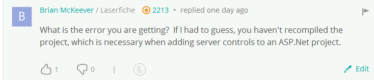

What is the error you are getting?  If I had to guess, you haven't recompiled the project, which is necessary when adding server controls to an ASP.Net project.

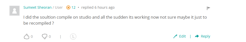

replied on March 27, 2015
I did the soultion compile on studio and all the sudden its working now not sure maybe it just to be recompiled ?

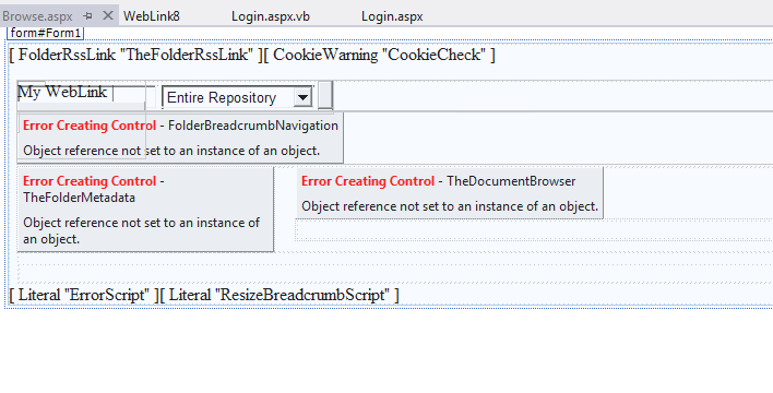

Hi Brian,
When I do I get the following.   When I compile and run the project Weblink does not load.
Avri
The WebLink controls don't support Design View.  There should be a tab at the bottom of the panel to switch to Code View.  Any problems with design view are unrelated to what happens at run time.
This is what I am getting at run time.
I do not know if running it will be feasible, i could not run it either unless i have VS on the server where weblink is installed, cannot get it to run locally myself, so have to just rebuild it and keep testing on the server itself if it is working or not. Kind of painful.

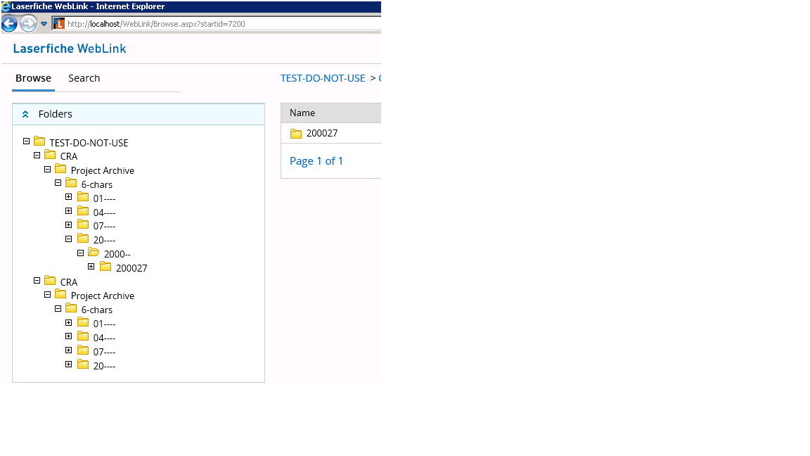

replied on March 30, 2015
Hi Melanie,
This really helps thank you.
I have one issue now.  The current folder name is included with its children.
Avri

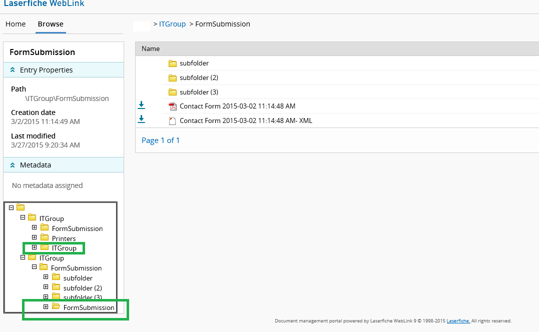

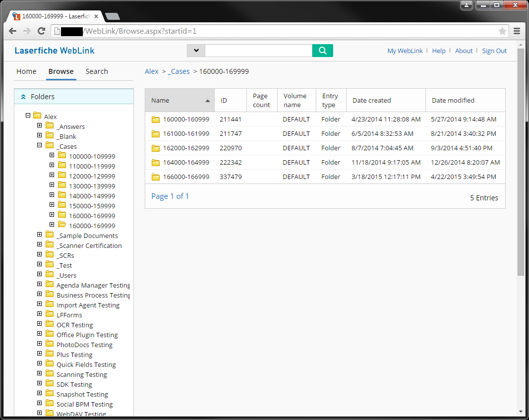

Thanks Melanie, but it works in a weird way. It creates a mirror of folder tree, see the image attached.
replied on March 30, 2015 • Show version history
Also noticed that the "tree/folder" that opens up takes out the other "main" folders as you can see from image,
ITGroup is top folder, click on Form Submission folder on the right hand and it opens up at the very bottom and the "printers" folder is no longer visible but instead there exists FormSubmisison at the very bottom.
Basically same issue as Avri Pointed out "its not same folder name" its actually the entire folder tree "repeating".

replied on May 4, 2015 • Show version history
Hi Avri,
I've spoken with development and to fix the issue of the selected folder from the right pane getting added into the folder tree as a duplicate folder, then please change the modified code suggested above from
If EntryIDToOpen <> args.SelectedEntryID Then
    ' Open a shortcut -- this function retrieves the path to the folder
    SetBrowserStartID(EntryIDToOpen)
    TheFolderTree.OpenFolder(EntryIDToOpen)
Else
    ' Open a child of the current folder -- the path is already known
    TheFolderTree.OpenChildOfCurrentFolder(EntryIDToOpen, args.SelectedEntryName, args.SelectedEntryFlags, True)
End If
to

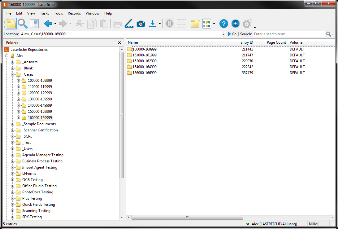

Basically, just remove the line "TheFolderTree.OpenFolder(EntryIDToOpen)" from the "Else" section. After you recompile the project, you should notice that the folder tree in WebLink 9 will now behave the same as the folder tree in other client side applications like the desktop Client and Web Access. When you select a folder from the right pane, the folder level that the selected folder is a part of will be expanded in the tree and the selected folder will be indicated as being opened. However, the selected folder itself will not be automatically expanded in the tree.
With the slight change to Melanie's suggestion, here is what you see in WebLink 9
And here is what you see in the desktop Client
In both cases, after I logged into the repository, I went into the right pane and I selected the "_Cases" folder followed by the "160000-169999" folder. Both applications behave the same in that the folder tree on the left will expand up to the same folder level that "160000-169999" is located at and indicate that folder being opened, but it does not automatically expand to show the subfolders underneath "160000-169999" in the folder tree.
Note that if what you are wanting is to also auto-expand the selected folder from the right in the folder tree on the left, then we can look into that as an enhancement for a future release of WebLink. However, the suggestions by Wes from this previous thread and Melanie in this thread (with the slight change) will get you the default folder tree behavior found in our other client side applications.

For the most part the solutions mentioned in this thread and the threads linked to this one have worked. However, when the client clicks a bookmark they configured in the Weblink Designer on Weblink home page the folder structure they see is duplicated as shown in the attachment.
The bookmark goes to the "Project Archive" folder and the result is a duplicate folder structure being displayed including the "Project Archive" folder and its parent, the "CRA" folder. The top level folder is not duplicated. If we log in to Weblink and select the "My Weblink - Browse" link instead of the bookmark the initial folder structure is displayed correctly. However, if we click the "Search" link and then click the "Browse" link the duplicate folder structure comes back. If we click on the top level folder ("Test-Do-Not-Use") the folder structure view returns to normal. Doing a simple screen refresh does not reset the duplicate folder display issue once the issue presents itself. The scripting changes have been implemented as outlined in these threads but the problem persists. The Laserfiche server version is 9.2.1.635 and WebLink is at version 9.0.1.275 on Windows Server 2008 using IE 11. Has anyone else run into this?
Thank you!
Rob
