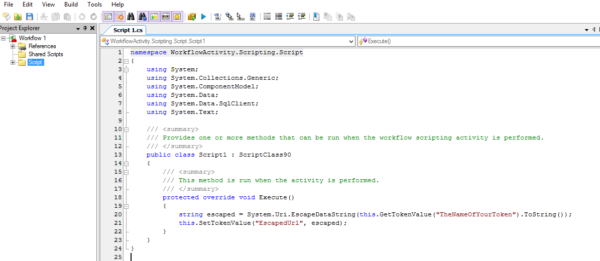

3) Double-click the script editor to edit your script. Paste the following code inside Execute() between the { and } directly below Execute:
string escaped = System.Uri.EscapeDataString(this.GetTokenValue("TheNameOfYourToken").ToString());
this.SetTokenValue("EscapedUrl", escaped);

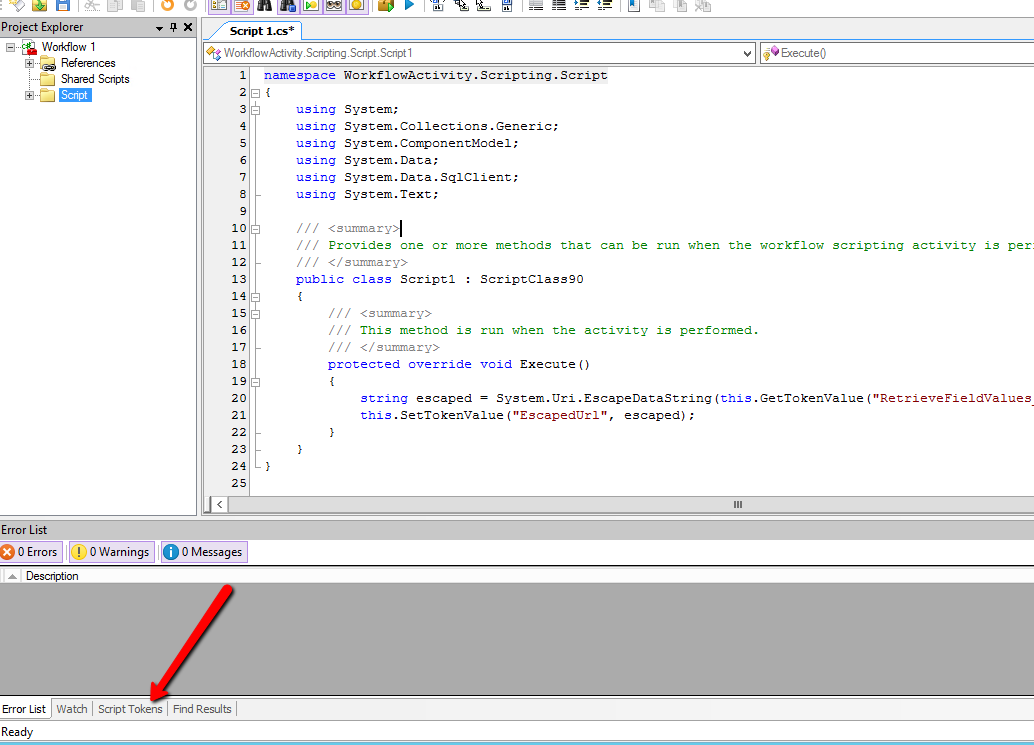

Your script screen should look like something like this:

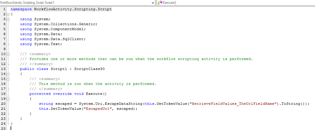

4) Now notice that it says "TheNameOfYourToken" in red. Replace this with the name of your actual token, without the %(). For example, if you have a token like %(RetrieveFieldValues_TheUrlFieldName), then the code above should end up looking like this:
5) Now we'll create a token from our newly escaped token. At the bottom of the editor, notice click the Script Tokens tab, as pictured and indicated:

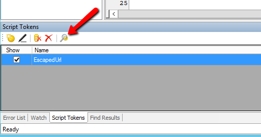

6) In the newly opened tab, click this button (AutoDetect Tokens):
If that worked, you should see the EscapedUrl item appear, as pictured above. If that does not appear, then you can manually enter that name under the Name column. This name must match the token in red in your script, which under my script is called "EscapedUrl" (though you can call it whatever you'd like). This is the token that contains the escaped value you will have wanted.

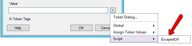

8) You can use your token just like any other token. The source activity will be your Script activity:
In this case, my Script activity is just called "Script".
