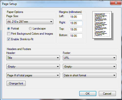

In Forms 9.1.1 my printed form has a 1 inch border from the edge of the form to edge of the paper on the top and both left and right sides of the form.  As well as the http address in the bottom left corner and date in the bottom right corner.  Is there a way to remove these borders as well as the http address and date so the form itself will fill the majority of the page?  thank you
replied on March 23, 2015
Hi Steven,
I believe that those options are controlled by the browser you're printing from and not within forms itself. If you're using Internet Explorer for example, you can goto the Options button and select Print - > Page Setup. You should get options similar to this that give you control over what is printed:
Regards,
Sheldon
