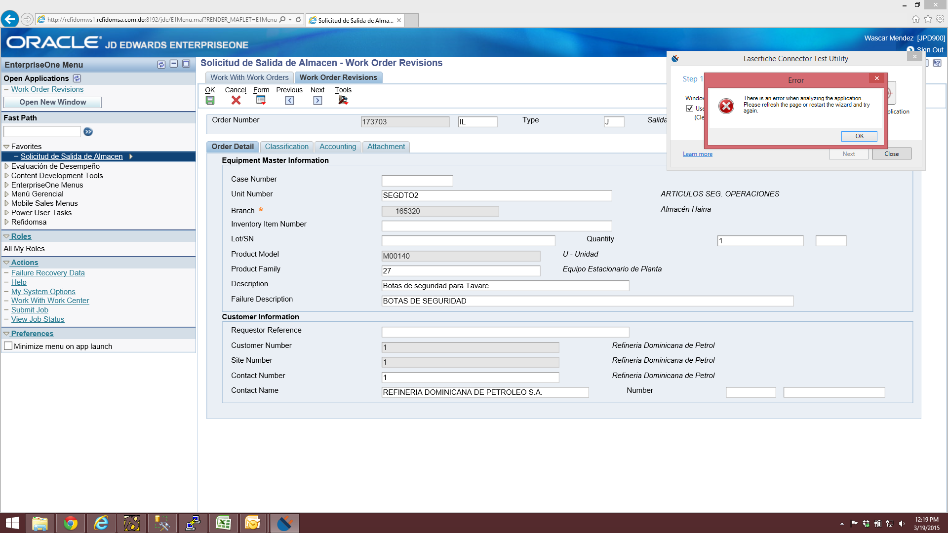

when we try the test utility of the Laserfiche Connector on a web application (JD Edwards V8.98) we get the following error "There is an error when analyzing the application.  Please refresh the page or restart the wizard and try again"
We did al that, but keep getting the same error message.  Attach a print screen of the error.
replied on March 20, 2015
Would you please attach the log file for Connector Test Utility? The log files are stored in the Libraries\Documents\Laserfiche Connector folder. Log files will be created each time the utility runs. Please also have a check whether there's an XML file generated. Attach the XML file as well if exists. Thanks!

Ricardo,
The log indicates you have never tried to uncheck "Use Javascript to detect fields instead of UI automation" on the first step. You might try to clear the option to see if it works.
Thanks!
replied on July 17, 2015
Removing the checkbox "Use Javascript to detect fields instead of UI automation" does correct this as I ran across this same issue earlier this week.
