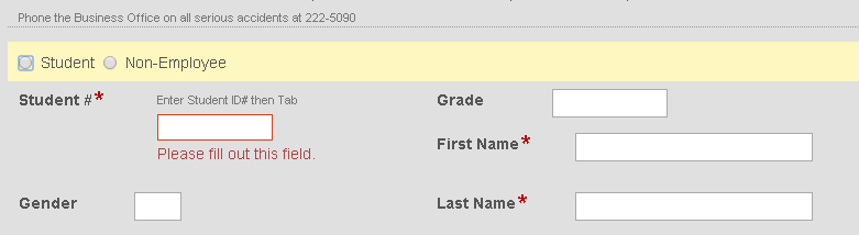

I am using position:relative;float:left to put a line side by side that has show/hide rules attached to it. My problem is that the next line that is set to inline-block is no longer being set side by side but rather to the right under the first line and stacked. How can I fix this?

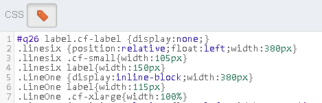

I was using inline-block but I had show/hide rules on part of the row. When one part of the row was suppose to be hidden it would not hide when it got to the repository. In another post I was told that the inline-block function will not allow for the show/hide rules when a form is being saved to the repository. They had me change to the position:relative, float:left which worked but now I am having field alignment issues.
Here is my code.
.linesix is for putting student# and grade side by side.
.LineOne is for putting first and last name side by side.
