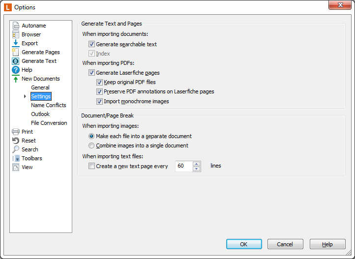

What are you settings set to under Tools>New Documents>Settings

I'm tempted to think it's something specific with those particular PDF's. I've set my options to the following:-
And I can import PDF's with no issues in both colour and B&W.
I would open a support case with Laserfiche and provide the PDF's to them so they can troubleshoot this further and work out what specifically is causing this.

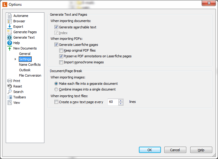

To workaround this for now try changing the following:-
See if that helps!

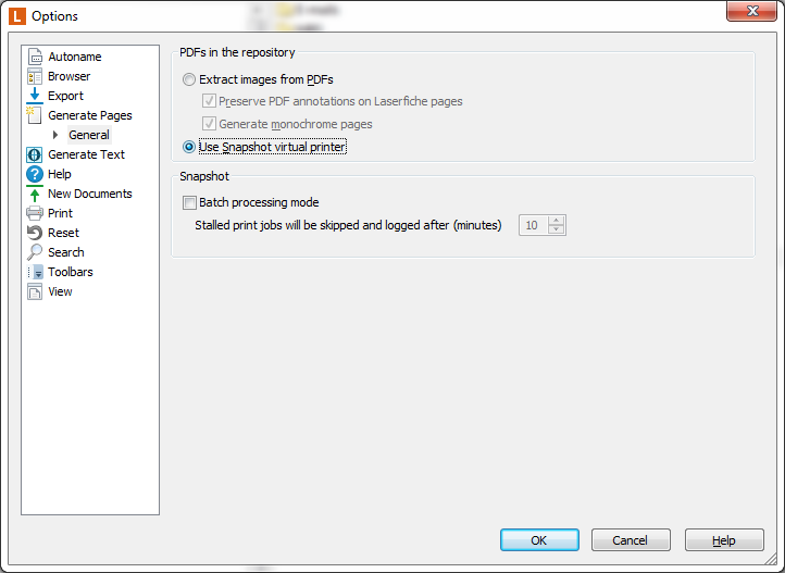

Snapshot virtual printer option is not working. Instead of that: open pdf, file > print using Laserfiche snapshot and store to repository generates the pages for all DPI's file without problem.  Still it has the issue to read the barcode when I reprocess the documents.
