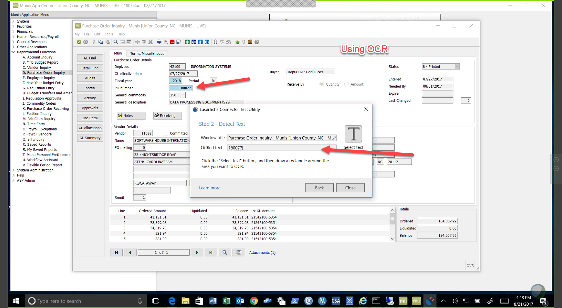

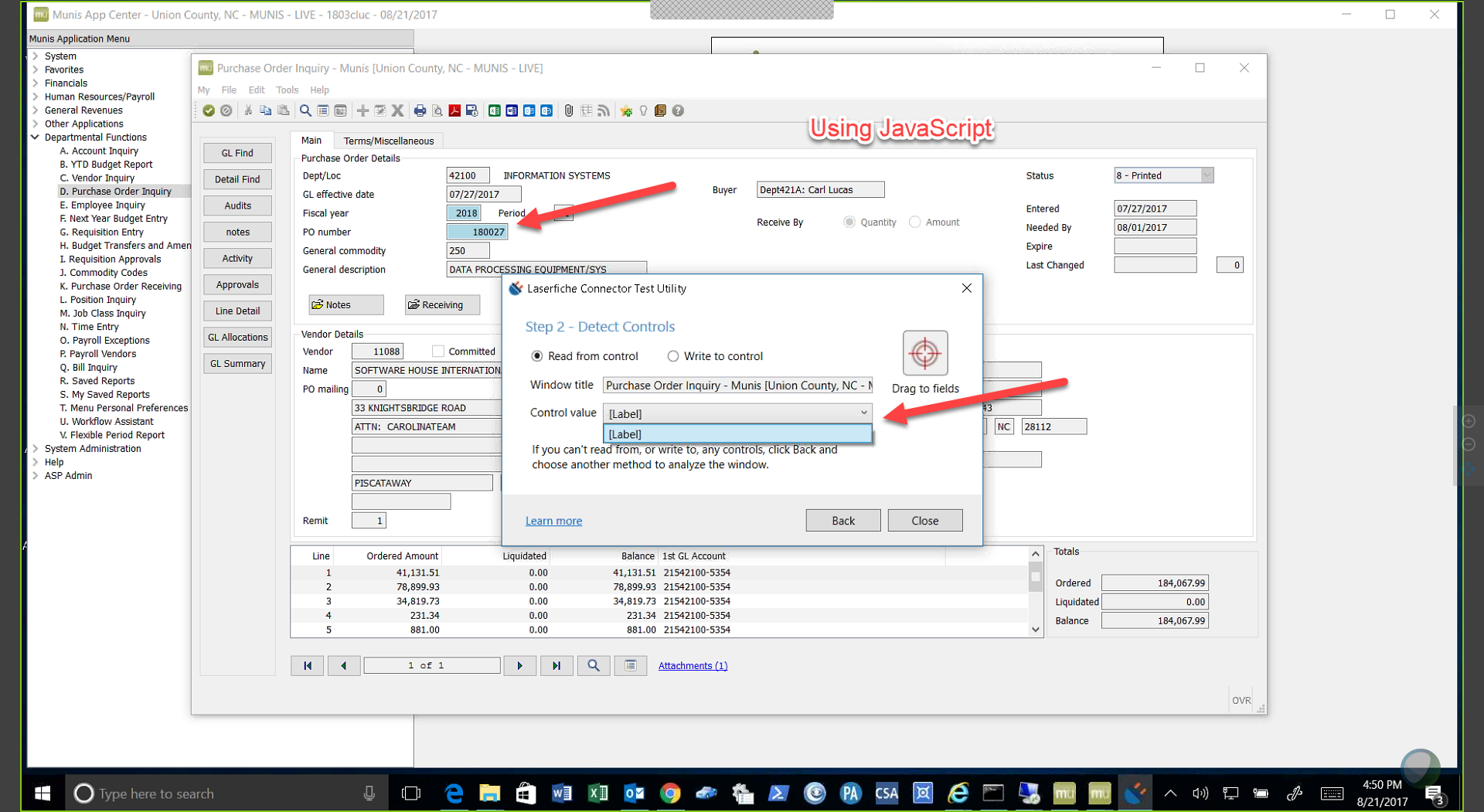

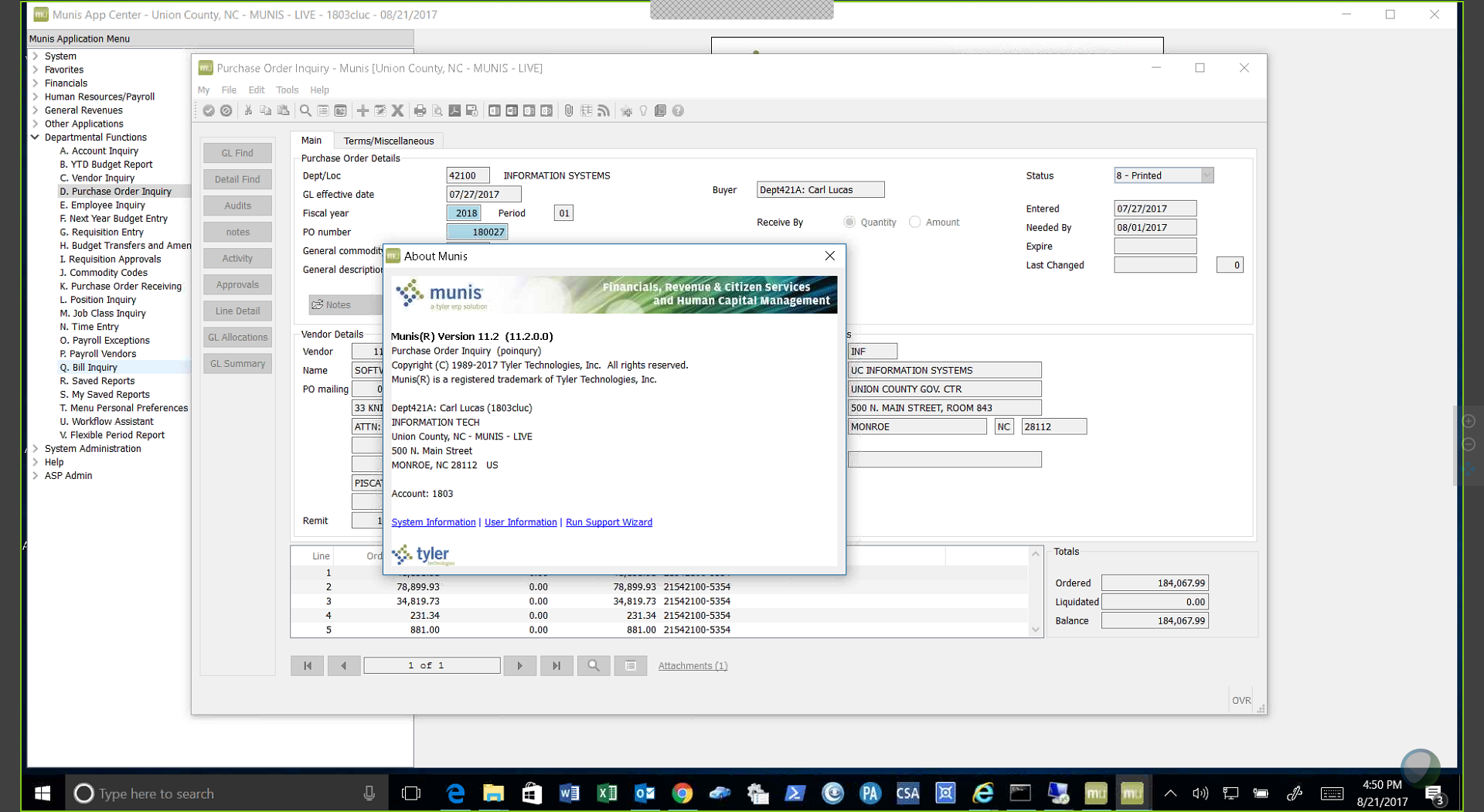

Hi Justin,
I tested Connector this week with Munis 11.2 and I was only able to get the OCR function of Connector to retrieve values.  If I used JavaScript or UI I was only able to see the control, but not the data within.  Is this the same behavior seen in the past?  Is there something I need to check within the configuration to use JavaScript specifically?
