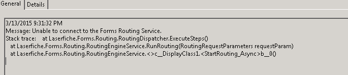

I recently upgrade a client from Forms 9.1 to 9.2, now everytime when trying to save under process modeler, they will receive an error message "unable to connect to the forms routing service."  The weird thing is that it does save the information also, but when submitting forms/processing it will get terminated.

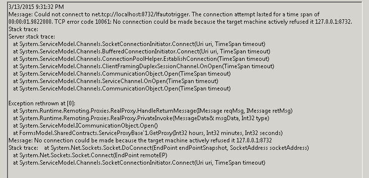

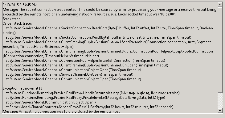

Attached screenshot in event viewer:

Try using netstat to see if some other process besides RoutingEngineServiceHost.exe is using port 8732
replied on June 12, 2015
I ran the netstat command on my local machine and on the server and there appears to be nothing running on port 8732. Does Forms Routing Service run on port 8732? Perhaps it is blocked in the firewall.

In C:\Program Files\Laserfiche\Laserfiche Forms\Forms\Web.config you should see some end points mapped as
<endpoint address="net.tcp://localhost:8168/lfrouting" binding="netTcpBinding" bindingConfiguration="timeoutBinding" contract="Laserfiche.Forms.Routing.IRoutingEngineService" name="" />
<endpoint address="net.tcp://localhost:8732/lfautotrigger" binding="netTcpBinding" bindingConfiguration="timeoutBinding" contract="FormsModel.SharedContracts.IAutoTrigger" name="" />
<endpoint address="net.tcp://localhost:8736/lfformexport" binding="netTcpBinding" bindingConfiguration="timeoutBinding" contract="FormsModel.SharedContracts.IFormExportService" name="" />
When you run netstat -ab, then it should return
  TCP    0.0.0.0:8168           [hostname]:0                LISTENING
 [RoutingEngineServiceHost.exe]
  TCP    0.0.0.0:8732           [hostname]:0                LISTENING
  TCP    0.0.0.0:8736           [hostname]:0                LISTENING
If there are any other processes using the ports that Forms tries to use, then you'll have to correct the matter accordingly.
I think we have resolved the issue. We were running the Service under a network account. I swtiched it to Local System and we are able to save changes in Forms now.
