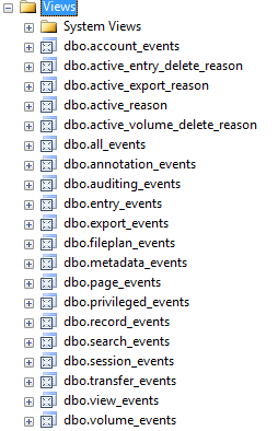

Out of curiosity, what type of report are you looking to create? The existing database views provide a lot of options.
replied on March 13, 2015
I agree with your statement on using Crystal Reports versus Audit Trail when it comes to grouping or reporting on relationships. That's a great use case for Crystal Reports.
Changes to a field value are logged in the [propval] table and mapped with more detail in [entry_events] view.

I think you would be able to get all the information you could desire for Crystal Reports from a combination of mappings in the Audit Trail database,   Repository database in question, and a proper configuration of which events to record (not all events are setup to record by default and as Chris mentioned, the date range has a factor). But it does take a combination of all three to get you there.
