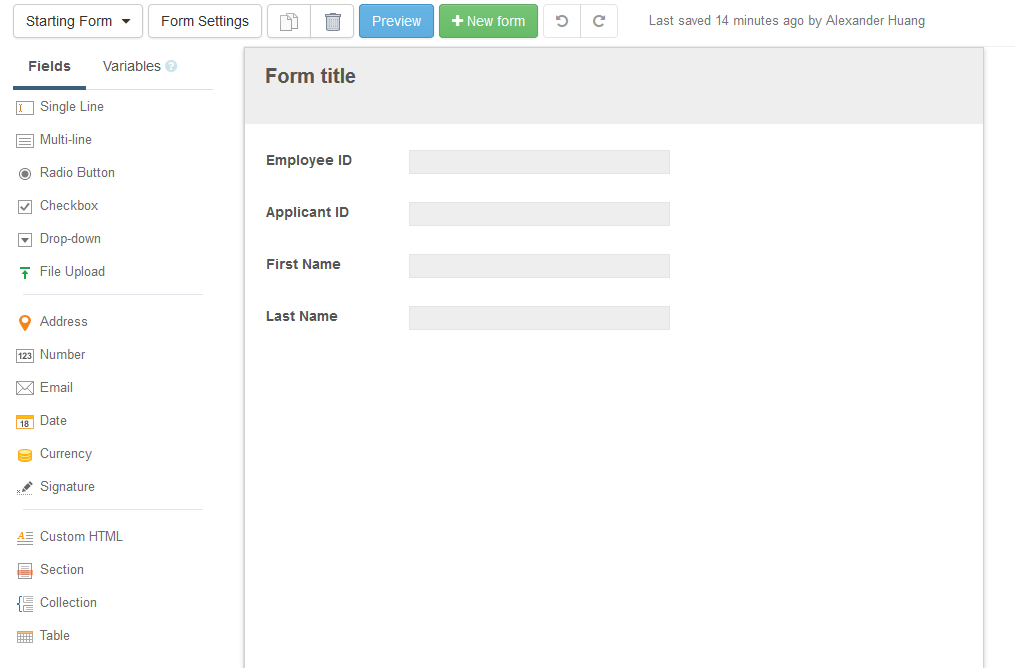

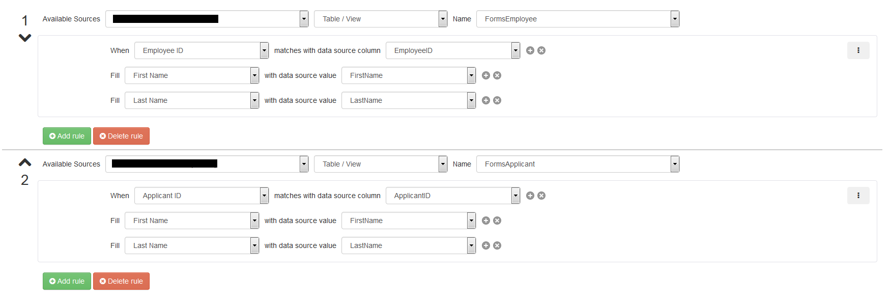

I've setup a form with four single line fields for employee id, applicant id, first name, and last name. I have two lookup rules, the first one looks up the employee table and matches the employee id to then fill the first and last names. The second lookup rule looks up the applicant table and matches the applicant id to then fill the same first and last name fields.

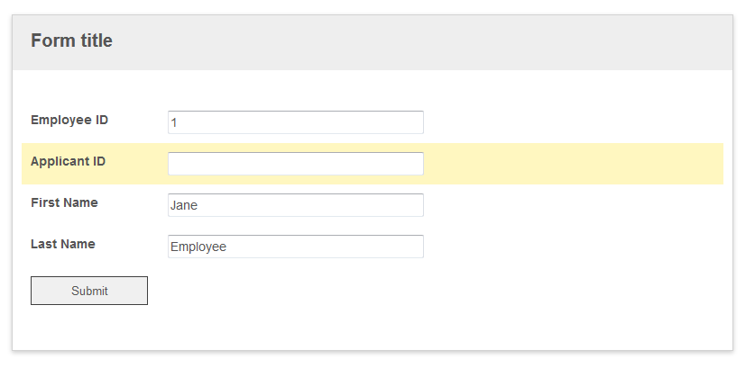

When I start the process and first fill in an employee id and tab out of the field, it fills the first and last names properly and the values remain there. The applicant id field is left blank as there was nothing to input into it.
If I start a new process and skip the employee id field and fill out the applicant id field and tab out of it, the first and last names of the applicant are then filled in.
Here are screenshots of my form and lookup rules and sample form inputs:

I imagine this is done by design. Imagine I enter a valid value into Employee ID and it fills in the first and last name field. Then if I change the Employee ID to an invalid Employee ID, it should empty out those fields as their is no longer a match and the last thing you want is for incorrect data in the fields. I have no issues with the way it is functioning but I would like more ability to control when certain lookups are used.  Something along the lines of when Employee ID is not empty and it matches via the lookup then use Employee ID to fill the fields.  Then there could be a second rule that said when Applicant ID is not empty and it matches via the lookup then use Applicant ID to fill the fields.  There just needs to be more logic available for the lookups that utilizes the other variables in the forms. Similar to the logic available in the field rules.

The scenario about clearing out the lookup fields when the match field is changed to an invalid value works for me. For example, I enter a valid employee ID and the first and last names are filled. If I go back into the employee ID field and change that to an invalid value and tab out again, then the first and last name fields are cleared out.
I'm not as clear about what you're suggesting in the latter part of your post. I do see that the lookups can get confused when you input a valid employee ID and then a valid applicant ID and then modify the values by deleting the applicant ID and trying to get the first and last name back to what was found by the original employee ID entered in. You'd have to clear out the employee ID value, tab out of the field, go back into it and enter the value again for the lookup to re-run based off of that original value.
