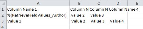

Good Afternoon,
I have the attached SDK Script code that is set to export a .csv file to C:\TestData.  The problem I'm running into is that the file is not passing tokens through to the CSV file.  I'm new to .NET but cannot figure out why the token value is not passing through to my CSV and I was hoping someone could help point me in the right direction.  Any help is much appreciated.
Thanks,
Nate

replied on March 10, 2015 Show version history
Hi Nathan. You just need to tell the code to get the actual runtime value of the token for you. The code for this is fairly simple. He are 3 different ways of doing this kind of thing (assuming WF 9.2):
            Dim values1 As String
            Dim values2 As String
            Dim entryIDValue As String
            values1 = me.TokenReplace("%(Entry ID) value1, value2")
            values2 = me.ReplaceTokensInString("%(Entry ID) value1, value2")
            entryIDValue = me.GetTokenValue("Entry ID")
For you, simply use me.TokenReplace on the string you are setting on the dataRow variable.
So:
dataRow = me.TokenReplace("%(RetrieveFieldValues_Author), value 2, value 3")
should do the trick.
