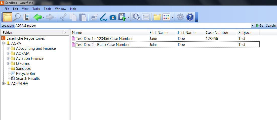

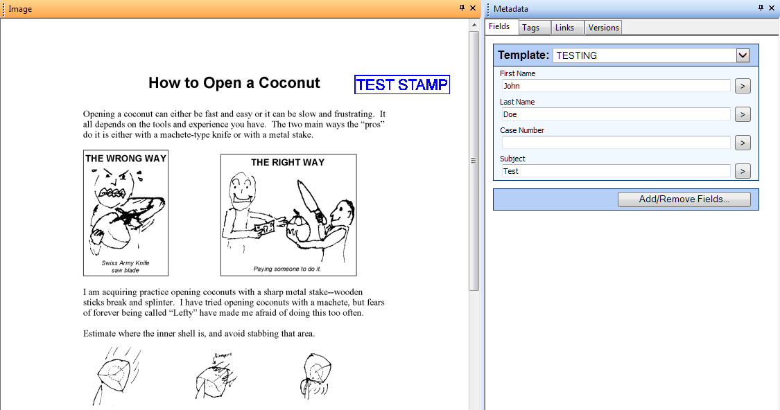

I just built a quick test for this and my workflow is able to find the correct document (the one with a blank field). I made the workflow very basic for testing:
LF Search: {[]:[Case Number]=""} & {LF:LOOKIN="AOPA\Sandbox"}
The next activity applies a stamp to the document returned in the search.
When I ran it, the stamp was applies to the document in which the "Case Number" field was blank.
Screenshots:
LF Client showing fields. Doc 2 has blank Case Number field:
Document after running test workflow that applied the stamp to the document returned in the search results (Doc 2):
Doc 1 (that has a case number) did not get a stamp applied.
So it seems to be working for me. Maybe try to simplify your search? I didn't specify a name of a document. I just searched the entire folder location.
