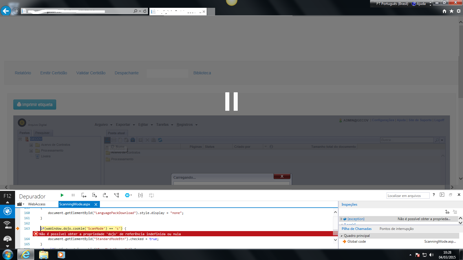

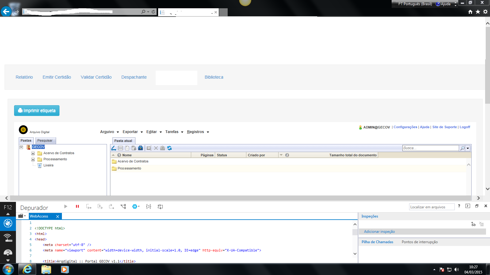

One of our clients(they use desktop with windows7 64 bits sp1), use laserfiche webaccess inside of na Iframe. As soon we upgrade the internet explorar to 11, when we click to open the scanning, it shows the box to download and install laserfiche webscanning, however it is installed already. It seems that it did not recognized laserfiche scanning installed in the desktop!
This only happen inside the IFrame, if we open laserfiche web access in the browser, it Works fine!
Using IE11 debug, i found that for some reason inside de iframe, webaccess wont recover a value to know if the scanning is installed. (Attached are 2 screenshots with the erro
Is there any configuration that we are mission in the iframe that is blocking webscanning?, we have tried in other browers and Works fine.

Hi Vitor,
I tried this in our latest released version of WA (9.2.0.67), and unfortunately I can reproduce your error. We're unsure why this errors being thrown, as it appears IE11 dropping a variable at some point. We filed a bug report (SCR124885 for your reference) to follow up and see if there's any way to fix this WA side.
Thanks for making us aware of this!

I didn't see, but was my mistake, i sad that was using 9.0.2.67, but I was using 9.2.0.67.
But ok!, i also tried on IE10 and worked fine, so i believe that the problem is with something with IE 11.
