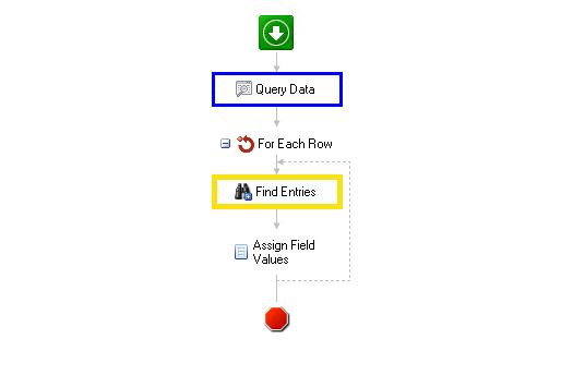

I have done that. It just sits at query data the whole time. I have attached what i have set up.

replied on March 2, 2015
Does the workflow service user have access to that file? How big is the file?
Once you get past the Query Data issue, your workflow will not do what you expect because of the use of Find Entries. If you expect to find multiple entries for each row in the CSV file, you'll have to iterate through them with For Each Entry. If a single document is expected, then you'll want to use Find Entry.

Just need to simply pick your CSV file from the table dropdown after you configure the activity and tie the document name column to the Entry Name value.
