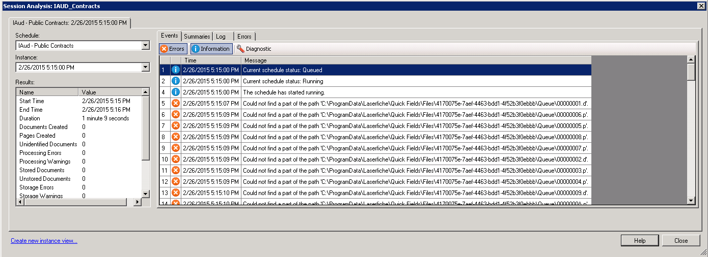

I have a Quick Fields session that brings in files to LF from a network folder that has been working like a charm for a year. All of a sudden it is displaying errors shown in the attached picture. All my other Quick Fields sessions work like before but this one suddenly refuses to bring the files into Laserfiche. I have not changed anything on the server or the QF session. It has not changed at all in a year. Any ideas as to what to look for judging from the error messages in the attached txt file?

Dears,
I am facing the same issue at a client side using QF agent.
Laserfiche capture engine is used as scan source, with no antivirus installed on the machine.
And set explicit rights for the windows account used by the Laserfiche Quick Fields agent service as logon to the “'C:\ProgramData\Laserfiche\Quick Fields\Files” folder, allowing full control on it and its subfolders and files.
And the error persist. I will remap the Retrieved / Moved folders an will let you know the result.
Attached is the error screenshot.
