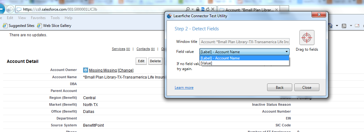

I just downloaded the latest test utility.
As shown in screenshot, while using test utility, I get the field name but no value. Is there supposed to be next button there? After I close from here the connector button is not added. Haven't had luck to add connector button. tried with chrome and IE 9. With chrome, couldn't even get to this point. Screenshot is from IE.

When you dragged the cross hair to the specific field, did you drag it to just the "Account Name" label by itself? Meaning, did the red selection rectangle just appear around "Account Name" by itself? If you drag the cross hair over to where it actually says "*Bmall Plan Library-TX-Transamerica Life..." is it able to select that specific field?
If you can provide a new screenshot showing the field that the cross hair is actually selecting (red selection rectangle), that would be helpful.

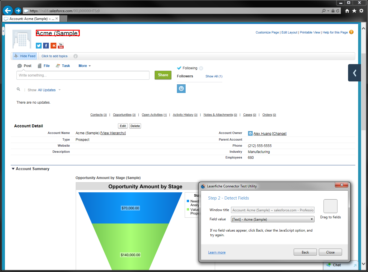

Also, for this specific scenario where you want to search by account name, I would suggest using a different field in the Salesforce account page. See the screenshot below
If you select the actual account name under the "Account Detail" section, then it picks up the [View Hierarchy] text as well. That's why I'd recommend selecting the account name from the top of the page. Also, click here to see a short proof of concept video of the Laserfiche Connector functionality being demoed.
