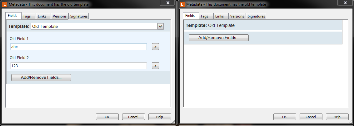

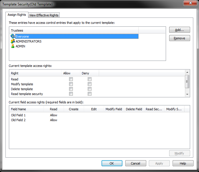

Here are some screenshots that show this proof of concept.
  1. This is how the template and field rights are configured for the old template. The ADMIN user (and any system accounts that are associated with the ADMINISTRATORS group) has all rights still, but for everyone else, they won't have rights any rights to the template and only read rights to the fields.
  2. This is what the metadata looks like for both the ADMIN user (left) and non administrative users (right)

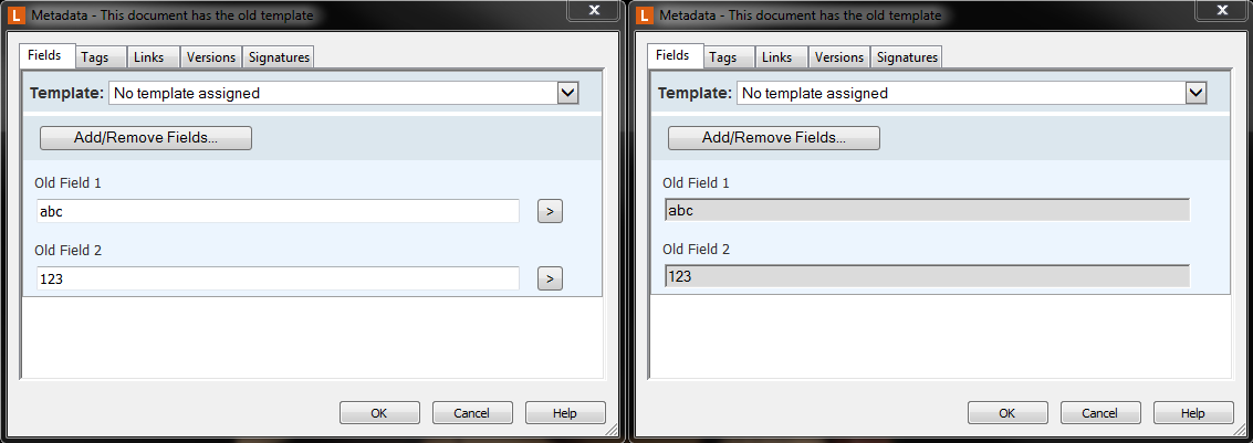

  3. After Workflow processes the document and unassigns the template (note that this works because the Workflow user is part of the ADMINISTRATORS group), this is what the metadata looks like now for ADMIN (left) and non administrative users (right). ADMIN can still edit the fields, but it is read-only for all others (non administrators)

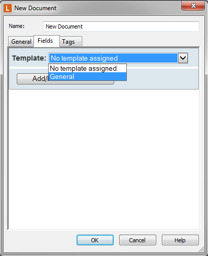

  4. Lastly, if a non administrative user then tries to create a new document (import, scan, etc.) they will not be able to select "Old Template" when assigning field data

One workaround may be to use Workflow to just unassign the current template from the documents. The fields will remain associated with the document as independent fields. Then as long as the user has "Read" rights to the fields, then they will still be visible. That way you can still deny "Read" on the template itself.
