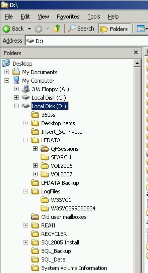

Could someone help me with exactly which directories and files need to be restored..?
I think the whole lot was just a very standard install and lives under the LFDATA folder on the D: drive...
Many thanks in advance...
