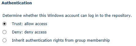

What is their Authentication set to? If it's not already, try switching it to "Trust: Allow Access".
replied on February 19, 2015
It's set to Trust: Allow access

This can also be caused by the properties for the Everyone user.  Remember by default all users are part of the  "Everyone" User.
In the Laserfiche Admin Console check the following:
Users and Groups - Everyone - Properties
Make sure it is set to either
Trust: allow Access
or
Not Set.
If it is set to Deny:deny access you can get the same error using Windows authentication,
