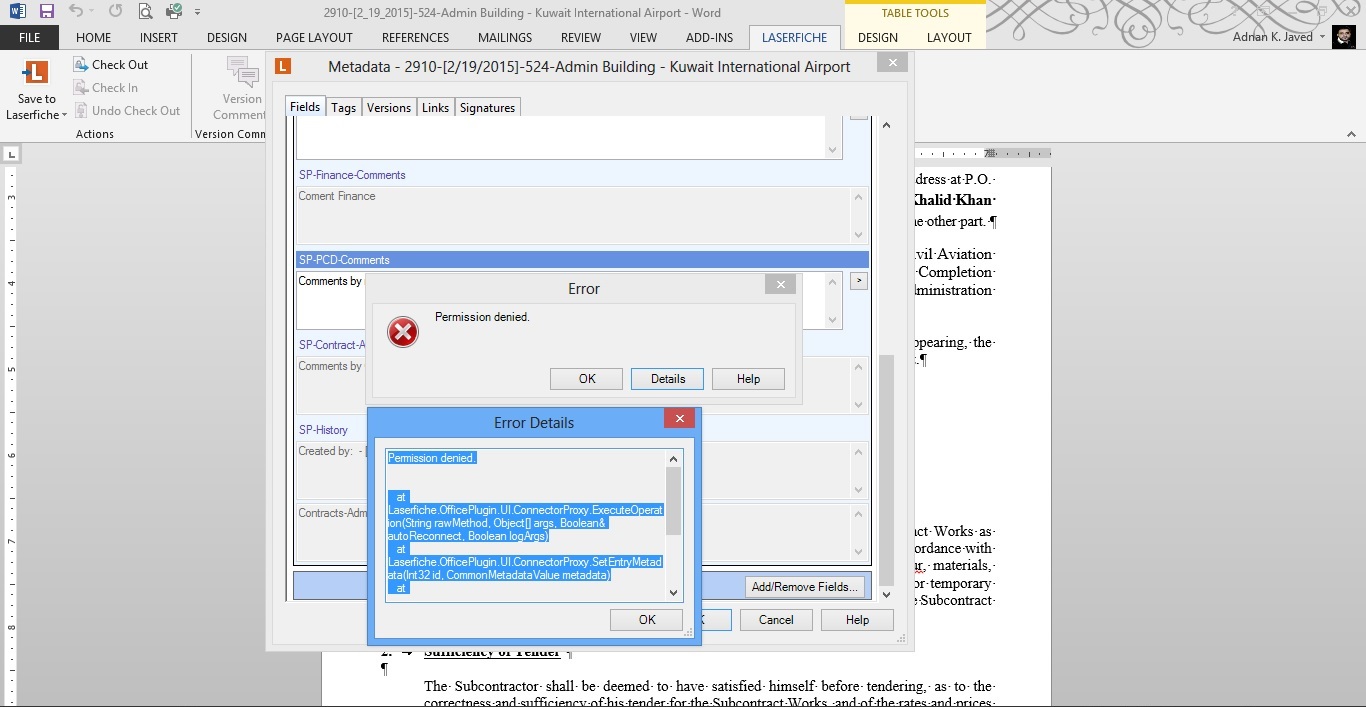

When i am trying to save the Metadata from MS Office it gives me a Permission Denied Error as below:
Permission denied.
   at Laserfiche.OfficePlugin.UI.ConnectorProxy.ExecuteOperation(String rawMethod, Object[] args, Boolean& autoReconnect, Boolean logArgs)
   at Laserfiche.OfficePlugin.UI.ConnectorProxy.SetEntryMetadata(Int32 id, CommonMetadataValue metadata)
   at Laserfiche.OfficePlugin.Common.DocModel.SharedArtifact.SetMetadataValue(CommonMetadataValue metadataValue)
   at Laserfiche.OfficePlugin.Common.ComponentModel.OfficePluginTaskProvider.<>c__DisplayClass2f.<>c__DisplayClass32.<ShowLFMetadata>b__2d(EventArgs eArgs)

The Issue is user specific. the Administrator can save Metadata in both Laserfiche Client & through Word client. but other users can only save in Laserfiche Client but it denied them in Word Client.
