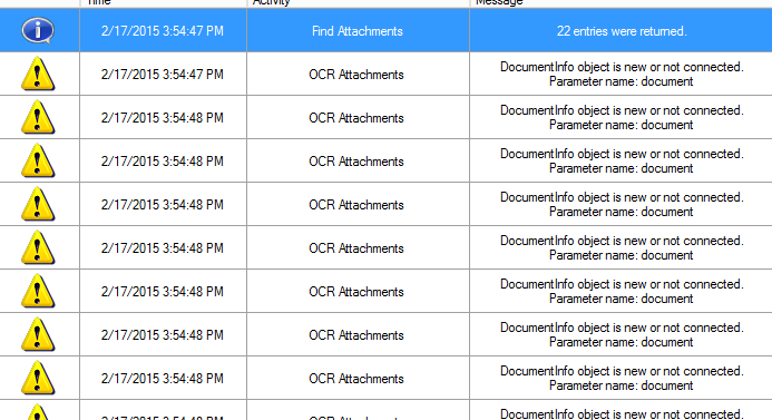

Hello all,
In my workflow, I am finding a collection of entries in a folder using Find Entries activity.  Using the 'For Each Entry' activity using the output from 'Find Entries', created a SDK script activity as follows.  I am on SDK 9.1
I am getting a warning DocumentInfo object is new or not connected. Parameter name : document
Here is the code snippet.  What am I doing wrong?

Thanks for the response Cliff.  I did try that already, you got c# syntax perfect. only thing is the entryinfo has to be casted to DocumentInfo class.  But that did not work either.
The script's default entry is set to current entry of the foreach.

Cliff,
Your post gave me an idea, c# vs vb, so created another identical sdk script activity using vb.net instead of c#.  Converted the c# code exactly to vb.net and what do you know, it worked.
Hope this will help others too.
Thanks for your tip
Bala
