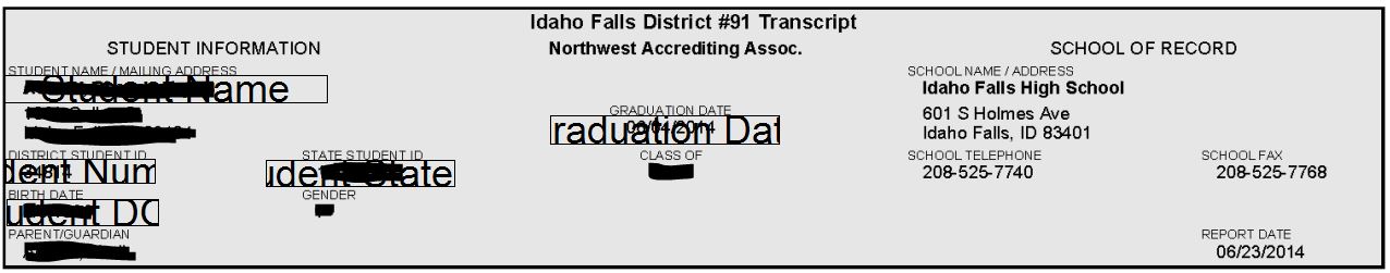

Here is what the top of the page looks like that it grabs the OCR from:

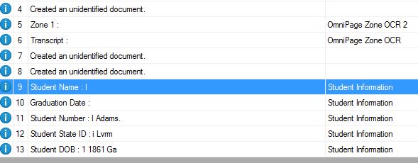

Here is the result when running the PDF through:
It seems to be trying the Zone OCR in the wrong places because it is grabbing the students address for the DOB and the Student Name for the Student Number.

Do the sample and the scanned image have the same resolution?
replied on February 17, 2015
I'm trying to figure out what the resolution of the PDF is, but I'm not finding it. Where would I look for that?
Nevermind. I played with exporting it as a .tiff file and changing out the sample image in Quick Fields until the zonal OCR fields looked close to where it was pulling values. After that, I adjusted the fields and then it worked like a charm. Thanks Miruna!
