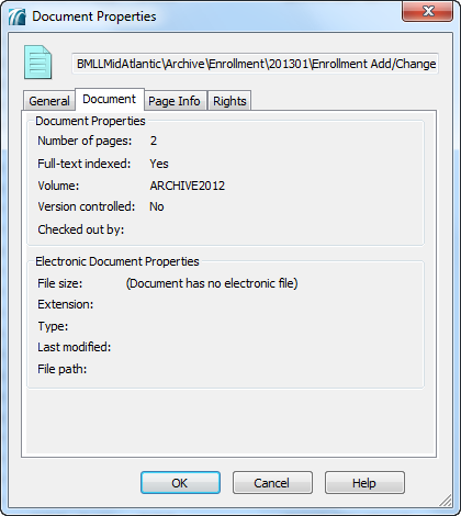

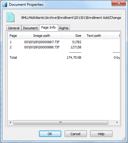

If that is the case, then you can view the document properties to get that information. Under the "Document" tab, it will tell you the volume the document resides in (physical volume if using a rollover) and under the "Page Info" tab, it should tell you the the path and physical file names of the *.tif and/or *.txt files. The path of the volume itself can be found by looking in the Laserfiche Administration Console.
replied on February 16, 2015

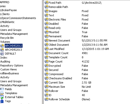

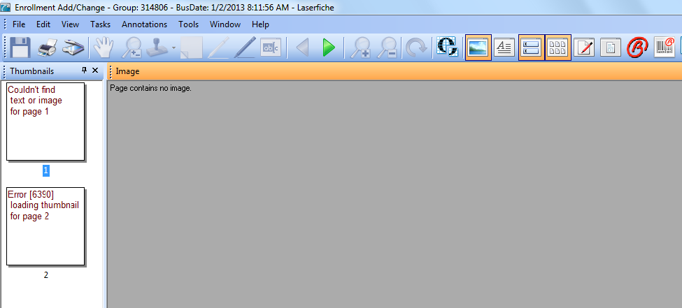

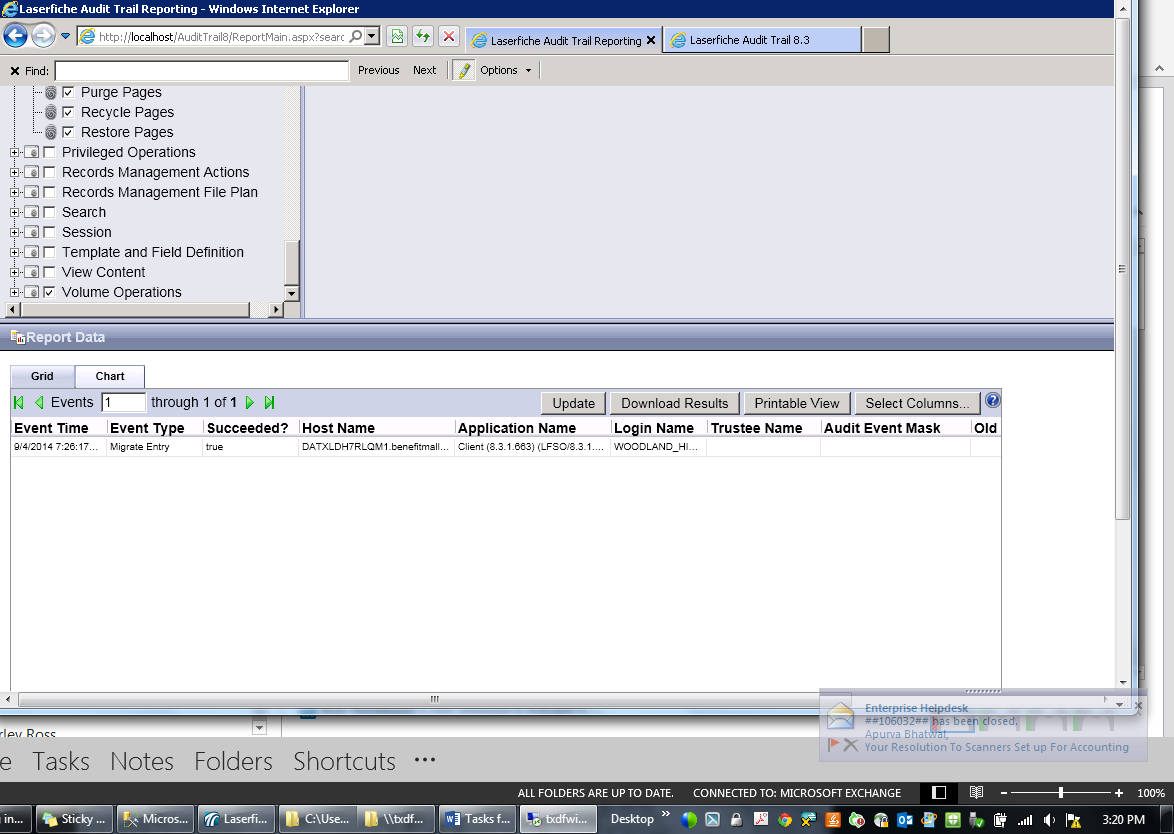

The document was migrated from one volume to another and is accessible in the repository, i.e. users can open the document and view its metadata, but none of the images are visible. See screenshots. Archive2012 volume doesn't have any documents. They may have been moved to another volume because none of tiffs were deleted from server. When I search by the tiff names in other volumes, the tiffs in results don't match with the metadata so those are tiffs for other documents. So used audit database to see migrate entry event. Wondering if there is a way to know what new tiff path or name is.
So under G:\ARCHIVE2012, there are no files or folders there? Was the repository moved from one server to another, but perhaps the volume files didn't get moved over? Was the ARCHIVE2012 volume previously set to a different path and then recently moved to G:\ARCHIVE2012, but perhaps the volume files didn't get moved over?
From your screenshots, Laserfiche is expecting the pages to be located in G:\ARCHIVE2012\00\00\08\00000887.TIF and G:\ARCHIVE2012\00\00\08\00000888.TIF respectively

Documents were migrated from default volume to Archive 2012 and then probably from archive 2012 to Archive2013. But I can not be certain about 2nd migration because I can't find tiffs in default or archive2013 volume. Also Archive2013 has about 3000 docs which are visible properly with images.
Yes no documents are available on that path. Also 00000887.TIF in other voumes have different pages. No matching page to document. Because new tiff name is created when it's moved to different volume.

So there is no way to figure out old and new tiff names by searching audit data, correct?
replied on February 17, 2015
The file name of the TIFF is based off of the store ID of that particular page in that particular volume. That information is not audited when migrating documents from one volume to another.
