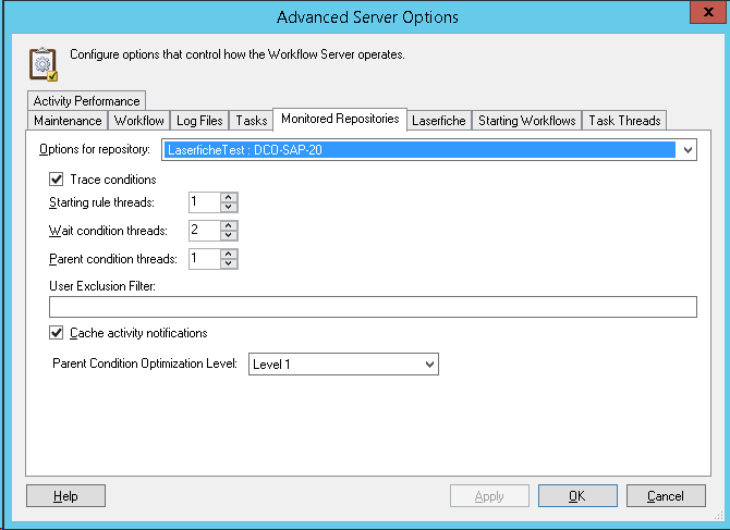

I changed the server notification port and LFAPI port and the subscriber can no longer communicate with the server. Changing the ports back to default fixes the problem. The only settings I see for the monitored repositories are in the screenshot below. Is there something I need to do to allow it to work with alternate ports?

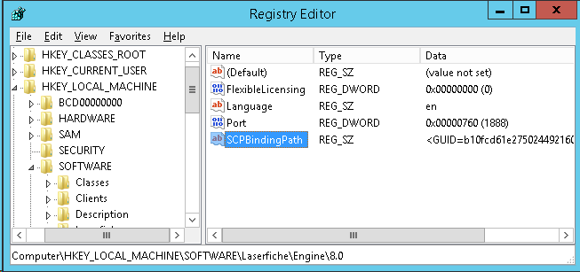

Changing the ports will not prevent the server from broadcasting itself. Setting up the registry key described in this KB article will stop it from publishing its connection point on the domain.
replied on February 13, 2015
I am unable to get that to work. I removed the prefix so it looks like this and restarted the service but a remote sever is still showing the repository when I run a repository search.

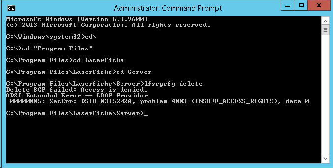

Right, you already have a connection point published for the server. That needs to be deleted first. The lfscpcnfg utility is located in the server install directory.
Please confirm by performing the following steps:
  1. Use the lfscpcfg delete command to delete the registered SCP
  2. Use the lfscpcfg list and/or query command to confirm that the SCP is no longer present
  3. With the registry change in place, restart the Laserfiche Server service
  4. Use the lfscpcfg list and/or query command to confirm that the SCP is not registered back
On the machine you're running the Client on, you'll want to confirm that the repository was not already attached (and hence, saved in the registry).
Can I do this through the Administration Console. I did try to run it via command line but I get the following access issue, even if I "Run as Administrator" although I am an administrator. I swear the security is overwhelming.
replied on February 16, 2015
You need to be a domain administrator. See this page for more information.
replied on February 17, 2015
awesome this worked, thanks!
