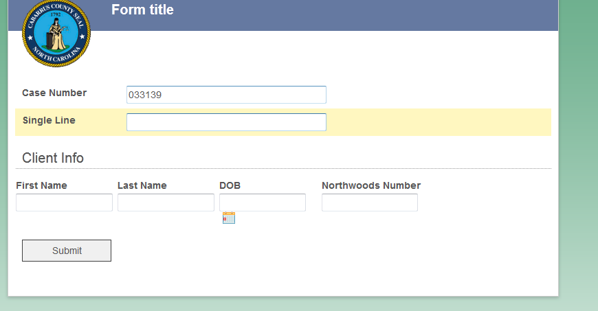

I'm currently working on a form that uses a stored proc to pull data when a case number is entered.

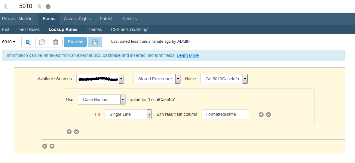

My rule is set so that when a case number is entered, the column FormattedName should be filled into the Single Line textbox.  At this point nothing is happening.  I have confirmed that the data source is set up correctly and the sql login account has full access to execute the stored proc.  What's confusing is if I use a standard table to pull back data, the form is populated as expected.  However, views and stored procs do not work.

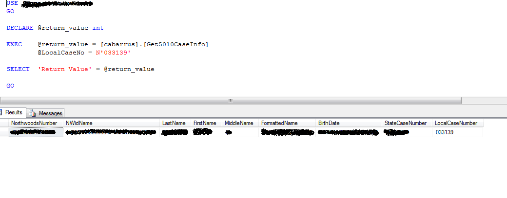

Have you tested to make sure one result is returning? To test through Forms, assign the retrieved value(s) to a drop down instead of a text field.

After digging a little further, the view and stored proc were in separate schemas (not dbo).  Once I moved those objects to the dbo schema everything appears to work now, albeit slowly.  The account had access to execute when the objects were in the other schema and the objects showed in the data source configuration in lf forms.  Anyone run across this?
