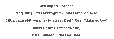

The initiator fills in a field that looks like this:
Every subsequent time the form is loaded (all access codes except initiator's) it displays this custom HTML field instead(dataset/Dash is the variable in question):
The code I'm using to accommodate the lookup:

I know this is kind of hard to wrap your head around, so please ask away!  The overall issue here (now) is that the variable {dataset/Dash} is storing as nothing.  So the finished form displays CIP #: Program - (blank) Rev: A
