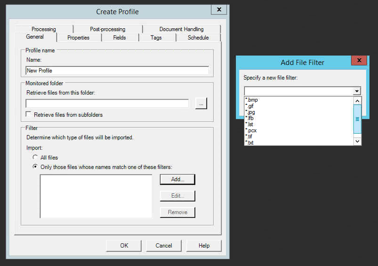

You can set filters on an Import Agent session.
The only issue is any document with that extension will be pulled since Import Agent does not know what was pulled from Laserfiche and what wasn't.  You will also need access to each users desktop from the machine/server that Import Agent is loaded on.

Once you have exported documents from the Repository, there is no way for Import Agent (or Windows) to tell whether those documents were once contained in Laserfiche.
You can configure Import Agent to only import documents with specific extension types, which means you could potentially whitelist all the document types you want (.jpg for example), and then the other documents on the desktop will be ignored. This is only an option if all the documents you want to keep on the desktop untouched have different extensions to all the documents from Laserfiche.
As Chris has said, one option is to have users import these documents into a unique location (and you can use a shortcut to make it user friendly), so Import Agent can identify the documents based on their Windows location.
