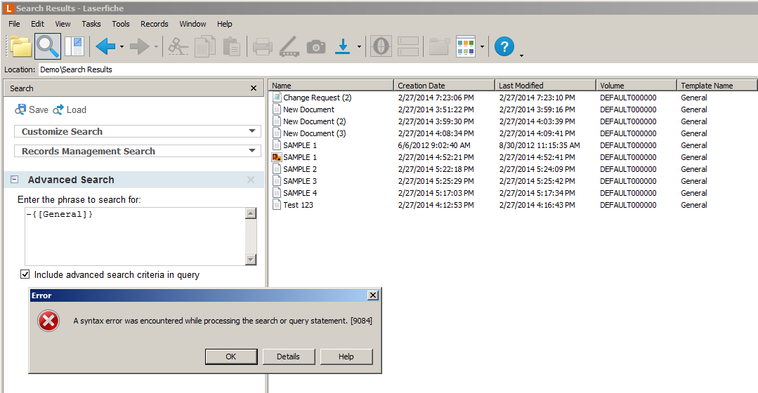

Looking the way how to exclude specific template from the search, i tried this in advanced search - it returns an error:
-{[Test Template]} and
{[]}-{[Test Template]}

replied on February 7, 2015
Thank you Alexander,
Both of them returned syntax error, attaching screenshot.

replied on February 8, 2015
You need to have an actual search syntax and append the -{[General]} to it. If your goal is to search for all entries that don't have the General template, then you'll need to first include the search syntax for all entries. You can try something like
{LF:ID>0}-{[General]}
If you just wanted to do something like search for all documents that don't have the general template, then you can use
{LF:Name="*", Type="DB"}-{[General]}
replied on February 9, 2015
Thank you Sir
