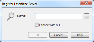

Is there some different protocol for being able to see the server between the Client and Admin Console?
We have a user that has both the Client and the Administration Console on their workstation.  They can attach the repository in the Client using the servername or the IP address no problem.  However when we try to register the server in the Administration Console by name or IP address is gives 9013 Permission Denied.  Not sure what the difference is.

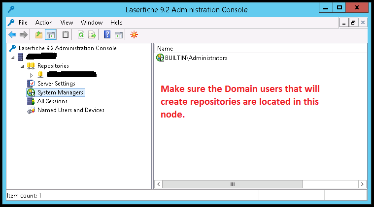

On the LF Server, open the LF Admin Console, in the Left pane, go to the System Managers node and make sure the AD domain user that is trying to create the repository is present.

We are not trying to create or register any repository.  We are trying to simply register the server in the Administration Console.  When you first open the Admin Console it asks you for the name of the server.
It finds the server name but we cannot connect to it because of Access Denied.  We can register the repository/see the server no problem through the full client.

Adding the domain account for the user to the System Managers list resolved this.
