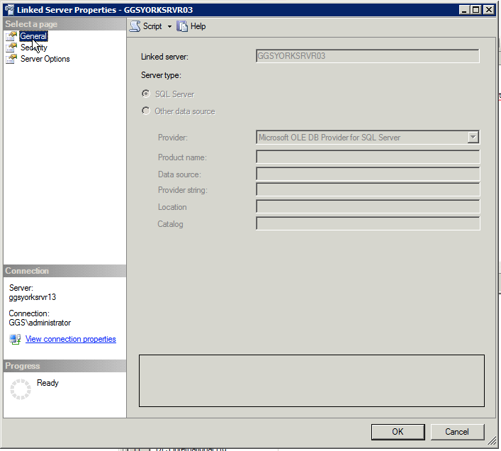

Right mouse click on Linked Servers and add new.
Enter the name and select the radio button for SQL Server

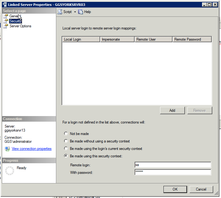

Then go to the security tab and select the last radio button and enter your log in info.  Hit OK.

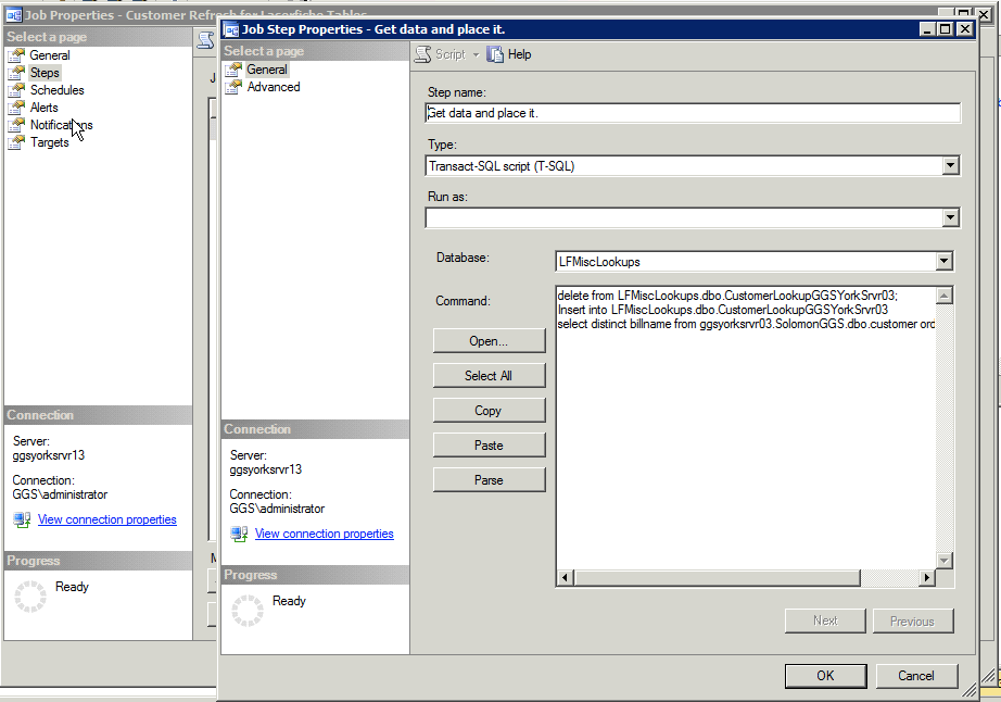

The second thing you need to do is either create a destination DB and table on DB Server A where the data you are about to mine can be stored.  All I did was make a empty DB and empty table.
The last thing you need to do is finish your SQL statement and test.
I did it by deleting what was already in the destination table and then inserting my select statement there. After that you can test if it worked with a simple select statement.

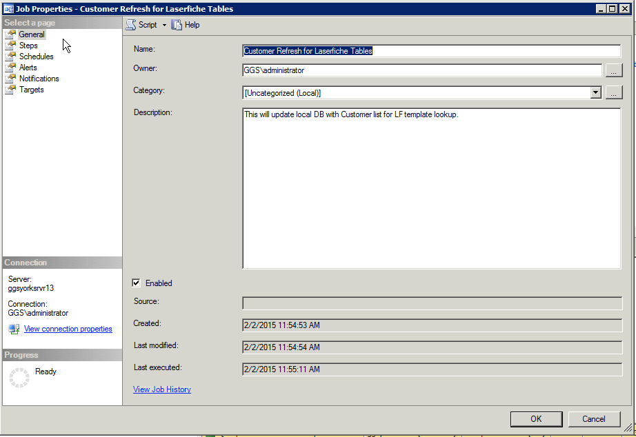

The third and final thing to do which is optional is make a job out of it.  I need mine to update nightly so I created a SQL Job to run it each night.
Right mouse click on jobs and select new.
In the general area give it a name and description.
Add a step and name it and paste your SQL statement in the command box.

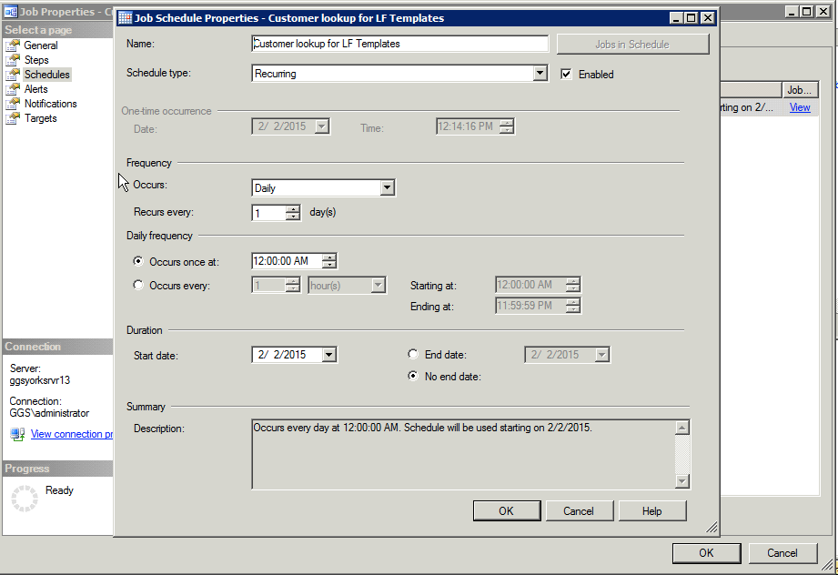

Select schedules and set a schedule suited to your needs.

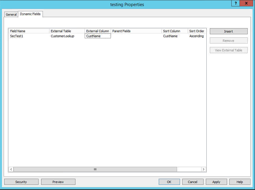

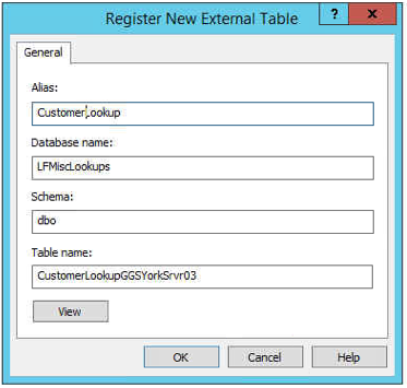

After that you just need to set it up in Laserfiche admin console which I am sure you know how to do but here are a few screenshots of that also.
Just remember your Alias can't have spaces and can't be over 63 characters.
There you have it all done.

I just wanted to attach a note of caution to people considering using the linked server as outlined in the above process.  It is a really bad idea from a security perspective to use the "sa" account for the creation of a linked server.  Also you should never use the "Be made using this security context:" option.  Here is a good article that discusses the security concerns and outlines strategies to create a more secure linked server https://www.brentozar.com/blitz/linked-servers/.
