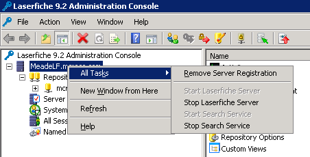

From the autorun menu, did you choose the server install or one of the others?  If you are looking for the LF Admin Console, that installs with the client and not the server.
replied on January 30, 2015
Go back to the installation process and install the LF 9.2 client as well as the Laserfiche Admin Console.  Once this is installed, start the Admin console, right-click the server name and register the server with the Admin Console.  From here you will then be able to configure the server, create your repositories, volumes, and manage your users and metadata.
Hey there,
Which .exe are you looking for? There should be lfs.exe in
%ProgramFiles%\Laserfiche\Server
Unless you installed to a different volume.
