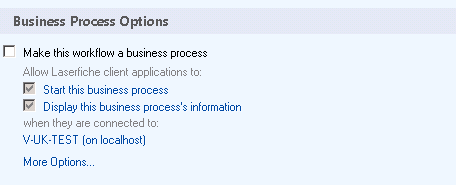

I've read through this problem and tried to come up with ideas. The easiest option may be to add in Business Process functionality to the Workflow, which means that the scanner would be able to log into the Laserfiche repository, and then Invoke the Workflow manually using a Business Process function along the toolbar.
Selecting the Designer space opens the properties for the Workflow itself in the properties pane, and within that you should see the below option.
Once this is ticked to yes, you can then allow users to start the Business Process from the Laserfiche Client. You can add in security and requirements/conditions for when/where the function is available.
You can add the button to the toolbar:
