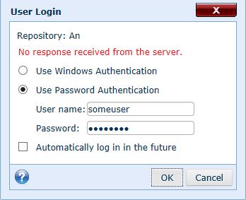

Whenever I try to log in to a repository from the web admin console, no matter how I try to log in, I always get a "no response received from server" message.
I've tried logging in with Windows Authentication on two different machines with two different AD accounts, and also with username/password authentication.
Any ideas or hints?
I'm running RIO 9.2 on Windows 2012 R2
replied on January 28, 2015
If you use the regular LF admin console, not the web based one, does it work?
Can you register the LF server you are trying to connect to using the IP address instead of the servername or vice versa?
Yes, works through admin console.
Tried with IP but same result.
Are you using SSL with the Web Admin console? Does it work if you do not use SSL?
replied on January 29, 2015
Same result whether or not SSL is imposed
Please contact your VAR so we can explore the issue further.
replied on February 3, 2015
RESOLVED:  When attaching the server through the admin console, I had SSL selected.  When I detached and reattached without SSL - all is well.
