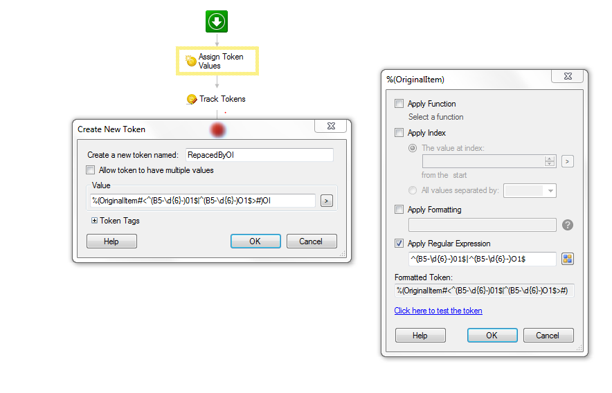

replied on February 2, 2015
Hi Mark,
You can try to create a new token using the token editor on the original item. The pattern matching in the token editor would contain all the possibilities : 01, O1 etc. :
%(OriginalItem#<^(B5-\d{6}-)01$|^(B5-\d{6}-)O1$>#)
The () will match the beginning of %(OriginalItem) excluding the ending 01 or O1 and followed by OI. :
%(OriginalItem#<^(B5-\d{6}-)01$|^(B5-\d{6}-)O1$>#)OI

replied on February 5, 2015
Excellent, Thanks everyone!
We used this with a few slight adjustments. Works like a charm so far.
%(PatternMatching_Reference#<(B\d{1,2}-\d{6}-)>#)OI
Then build some Routing tables for other possible areas that could error.

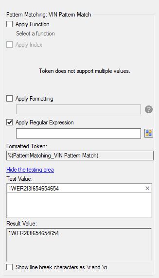

replied on June 9, 2017
Tanya,
I see this post was from a couple of years ago, but I am encountering the same thing with our VIN numbers.  By national naming standards VINs will not contain I's or O's, but only 1's and 0's (zeros).  So after my documents go through the OCR Process and then the Workflow does a pattern matching on the VIN to pull from the Lien or Title sometimes the VIN will return with I's or O's.  I am at a loss on the expression to use on my pattern matching token because you never know where it will show in the VIN and there could be multiple I's or O's.  The VIN will be anywhere from 6 to 17 characters in length.
Any help is truly appreciated!!
Robin H
Oklahoma Tax Commission
Pattern Matching does not replace values, it only does data validation and extraction. You can twist it into a semblance of it as indicated in the answer of this post, but that gets unwieldy fast when you deal with more unstructured data or longer strings like in your case.
Use the Token Calculator activity and its Substitute function instead.
