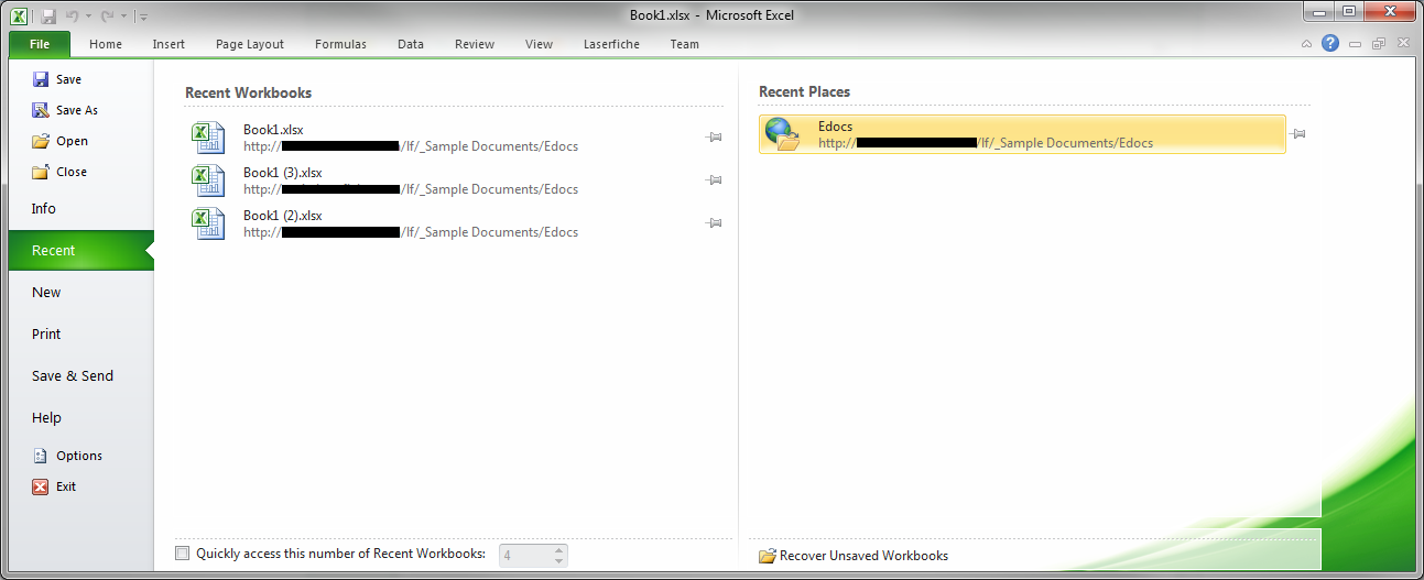

I have WebDAV configured and opened three different workbooks (Book1.xlsx, Book1 (2).xlsx, and Book1 (3).xlsx) from my mapped network drive. My repository path where those documents are located is just /_Sample Documents/Edocs. Here is what the "recents" section in Excel looks like for me
Do you see something similar or does it still show the temp location?
replied on January 27, 2015
That's how it's supposed to work.  Since it appears as a normal folder path there's no need to copy it locally, applications should be able to open it directly.  If you think you have it all configured correctly I would use a tool like Process Monitor to see what is causing the file to be copied.

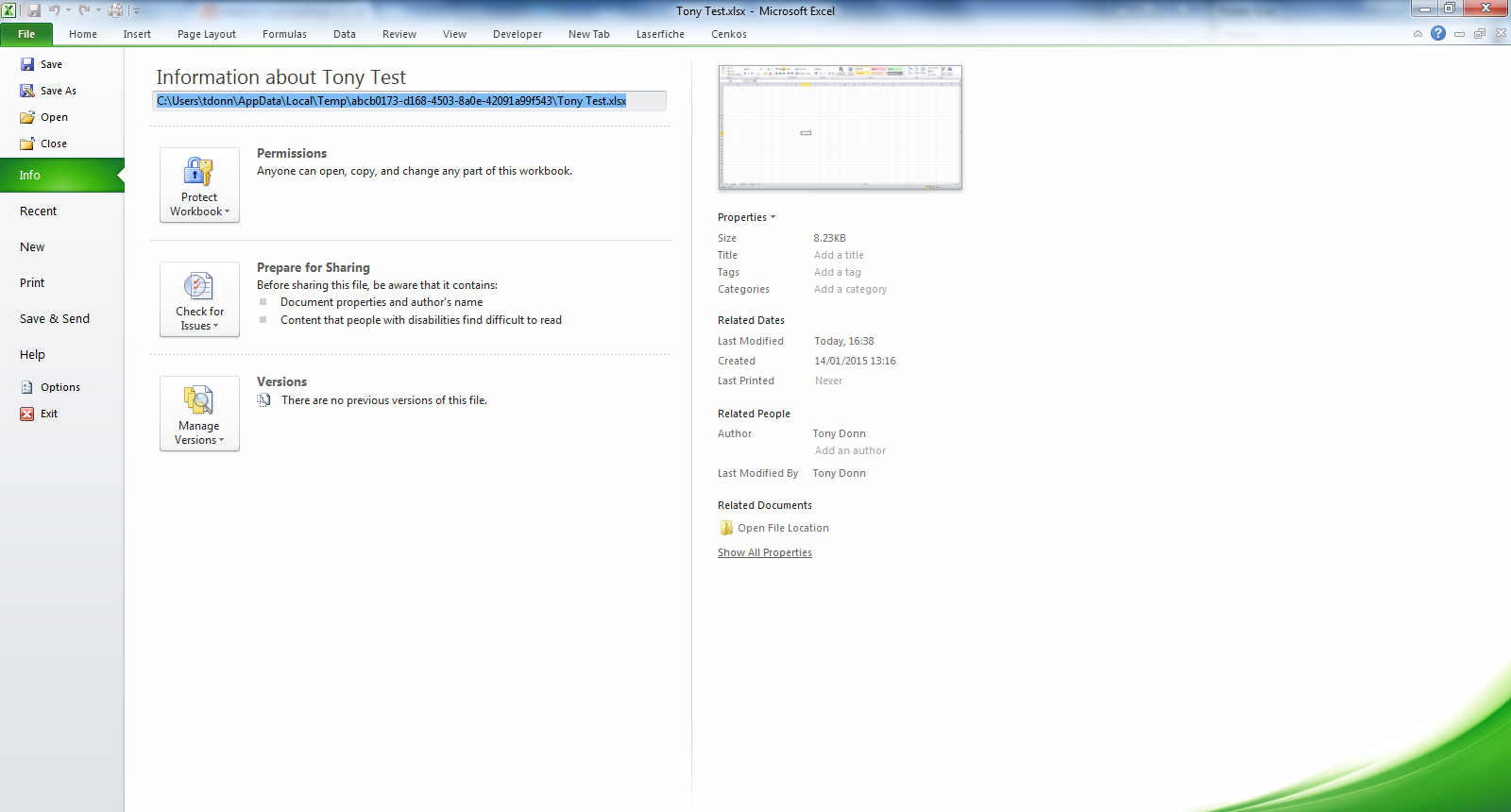

It does show the http location in recent however in the info tab it displays a local/temp location?
