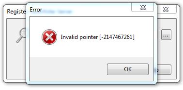

If I click ok the Admin Console launches, but I have to connect to a server. After I put the name of the server in, it then gives this error message:

I ran a repair on the installation and now the Admin Console opens without any problems, but when I try to select a repository I receive the following error:
Error Code: 16387
Error Message: Invalid pointer [-2147467261]

replied on January 22, 2015 • Show version history
What version of the Admin console are you running? Same as the LF client and the LF server?
I thought I was, but now looking at the server the admin console says that the server is on 9.2.0 build 485. The LF client and the admin console on the server say 9.2.0.472, which is also the version of the client and admin console on my machine that is giving the error message.
Launching the Admin Console from the server is working without any issues.
Please uninstall and reinstall the client and admin console on the problem machine, delete the client folder and try it again.  If you did not download a new install of the client, please apply SP1 again after reinstalling the client and admin console, then re-register the server and repository in the admin console.  If the issue persists, please open a case with Support so we can explore the matter further.
