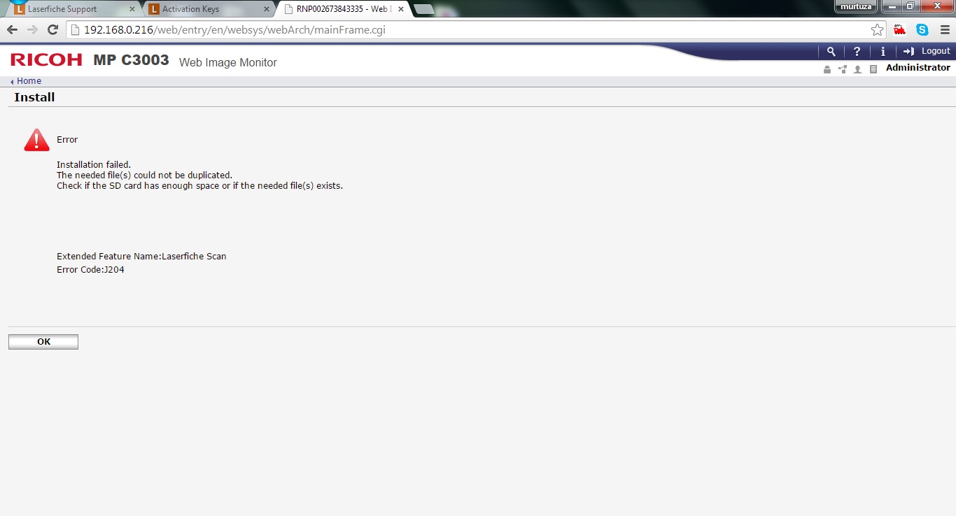

i tried to install the zip file on the ricoh MPC 3003 and getting the attached error.
Please if anyone know about the solution let me know.
thanks.
