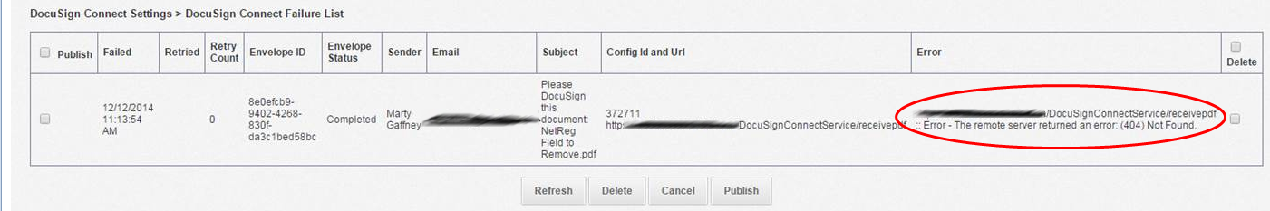

One of my customers is having difficulty configuring Docusign with LF.  I've attached the config files.  Everything looks correct, but is not working.
Mod edit: Removed attachment. Please redact sensitive information before posting documents. Attached image of error log.

Looking at your attachment, I see that the DocuSign Connect Service logs show a 404. This indicates that DocuSign could not reach the endpoint at all, which means it's likely a network or firewall configuration issue. DocuSign needs to be able to connect to the machine hosting the DocuSign Web Import Service. In our network, than means we have to install the Web Import Service in the DMZ.
To see if the endpoint is accessible, try going a URL like the following from a machine outside the firewall :
 https://yourmachinename/DocuSignConnectService/diagnostics/testlogin
If you get a 404, then DocuSign is unable to reach the endpoint. The success message should be "Logged into LF Repository" in the JSON of the response, which means that you are able to reach the endpoint, and that the endpoint is working correctly.

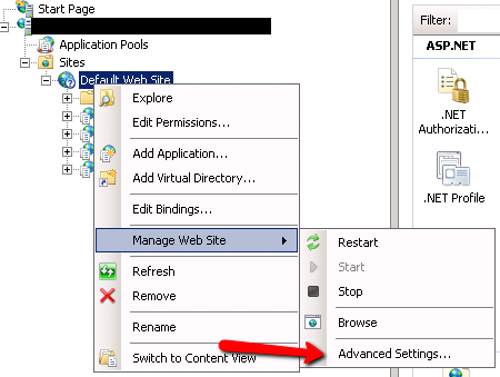

However, if you are still concerned, I recommend checking your settings in IIS rather than installing inside the Web Access folder, which is not the intended configuration.

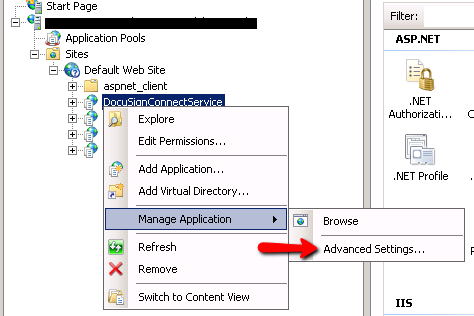

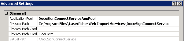

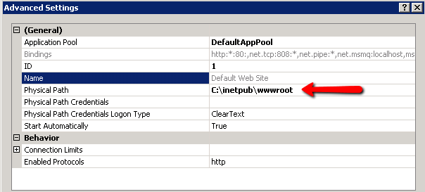

First, try checking the physical path for the default website, or whatever website the DocuSignConnectService application appears under:
Then you should check that the physical path for the DocuSignConnectService application is correct:

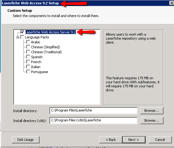

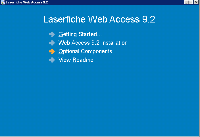

1) The Autorun package for Web Access:
does indeed contain the installer for the DocuSign Import service, but the Web Access installer:
does not. The Web Access Autorun package section for "Optional Components" allows you to easily launch installers for separate products like Web Accelerator and the SharePoint integration that are related to Web Access but are still distinct products and are not required to be installed on the same machine.

First, a full virtual path may not always correspond to a full physical path. For example, the physical folder DocuSignConnectService in a working installation does not actually have a folder within it titled diagnostics, despite the fact that the URL says /DocuSignConnectService/diagnostics.
Second, as implied in my previous post, an application (such as DocuSignConnectService) can (and probably will) have a different physical path than other applications and the default website physical path.
