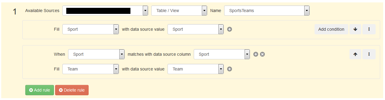

replied on October 6, 2015
Here's an example:
Below is a table in my database

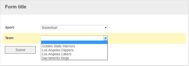

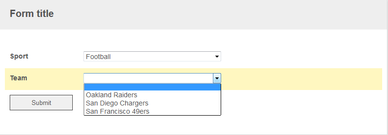

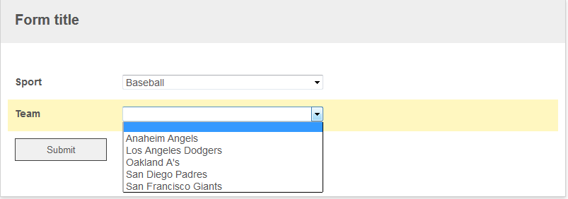

On my form, I have two drop down fields: one for the sport and the other for the team. This is how I would configure the lookup rule in Forms
Fill the "Sport" drop down field with the values from the "Sport" column in the database table. Then when the "Sport" that gets selected matches the "Sport" in the table, fill the "Team" drop down with the values from the "Team" column in the database table. The result looks like the following

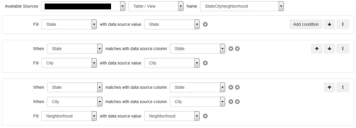

replied on October 7, 2015
Here's an example of a three-tiered dynamic field configuration in Forms for selecting a state, city, and neighborhood.
This works for me when the three drop down fields are columns in a table. The rules use the same logic you describe. The state drop down is always filled with the "state" values. The city drop down then depends on what the state is. Finally, the neighborhood drop down depends on both the state and the city.
