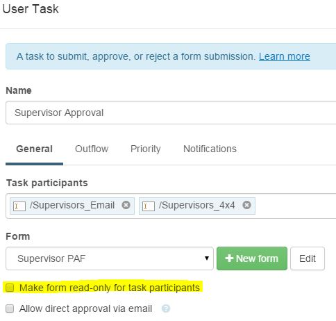

In the user task for the second task participant, simply check the box that says "Mark form read-only for task participants".
