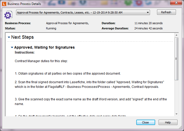

I am working on a BP and have noticed that the spacing does not come out right.  It decides to put extra spaces between lines sometimes and I can't get it to stop doing this.  Any ideas on how I can enforce this?

Yes, I've been revising, testing, revising, testing this process quite a few times and it seems the problem does not go away.  This morning, I looked again at what is programmed into my BP step instructions and there is only one line between each sentence or number point, yet when I check what shows up during a test, it has added an extra line between some of the number points but not all of them (most of them).

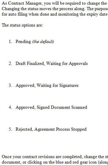

Following is (1) printscreen clip of what is programmed into the WF and (2) printscreen clip of what is showing up in the emal:

I can't reproduce the issue in your original post with spaces in the instructions.
The email one, though, it seems to be a caused by a combination of Workflow trying to be helpful and adding newline characters after each line and Outlook's HTML processing adding more space when it runs into HTML tags.
So your list ends up like this in the email body when Workflow sends (this was done as a feature request from users who complained their plain text emails were not correctly interpreted by mail clients because of the missing line break):
<ol><br>
<li>Pending</li><br>
<li>Draft Finalized</li><br>
<li>Approved</li><br>
</ol><br>
I think if you change your email so the list is on a single line and with no closing tags for line items, it will get around Outlook's processing:
<ol><li>Pending<li>Draft Finalized<li>Approved</ol>
