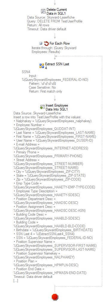

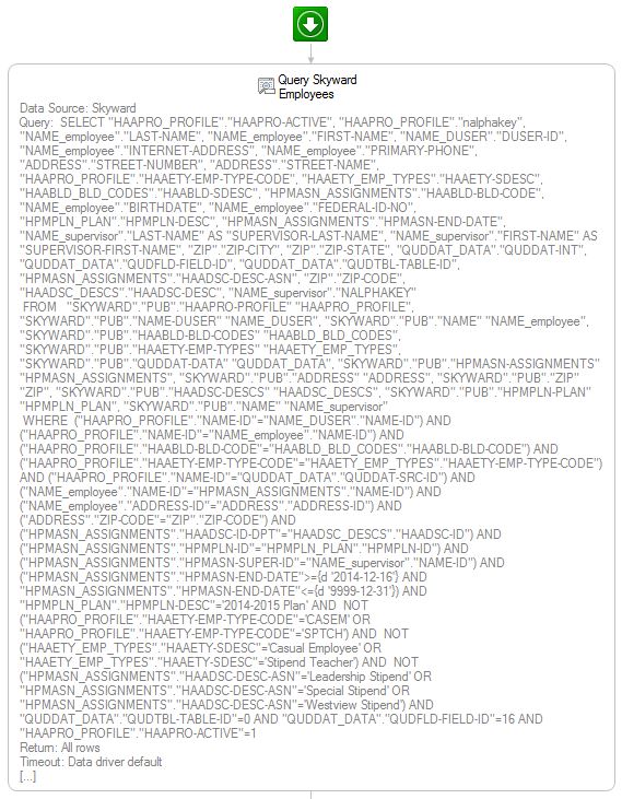

I am wanting to use Workflow to pull information from a Progress database and Insert it into an MSSQL database. In the workflow I have the following setup:
I can test the "Query Skyward Employees" activity and it brings back the correct number of results. The "Delete Current Data in SQL1" also works correctly.
The problem is with the "Insert Employee Data Into SQL1" activity. It is inserting the same record into the database over and over again. The information is correct for that employee, I just need the other employees inserted. Any ideas on what may be causing this?

You're using the token from Query Data, which defaults to the first row. You would want to use the For Each Row token for the current values.
That said, this setup is inefficient as each iteration has to make and close a connection to SQL. It would be better to use a Custom Query activity to insert the results of the first query directly into the second table without bringing them into WF.

Miruna, thank you for noticing that. I knew it was something simple. I will make the change.
As for the Custom Query, I am working on one, but will need some time to create it. For now I will just use this one and once I have tested the Custom Query I will switch it over. Thank you again for your input.
