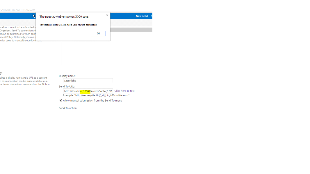

I have installed a Sharepoint server that I need to integrate with the Laserfiche Web Access Server. The LF Search and LF Web Parts are working fine. I need to configure the Records center and when I get to the create a new send connection to Laserfiche I am stuck. I can't seem to get the Send To URL to be verified. I get the "Verification failed: URL is not a valid routing destination. I have installed the LFSHintegration on the sharepoint server and am pointing to the sharepoint server in the url
http://localhost/LFSPRecordsCenter/LFWSSIntegrationService.asmx

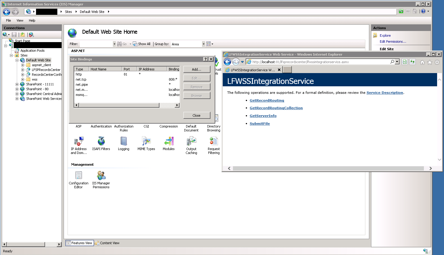

replied on December 16, 2014
Please make sure that you are pointing to the correct site that the LFSPRecordsCenter web application is installed under. By default it would get installed under the Default Web Site. If you are using a different port binding for the Default Web Site (since maybe SharePoint took over port 80) then you should need to reference the site with the actual port binding.
For example, if you now have the Default Web Site running on port 81 and the LFSPRecordsCenter web application is installed under there, then the web service URL would be
http://MyWebServer:81/LFSPRecordsCenter/lfwssintegrationservice.asmx

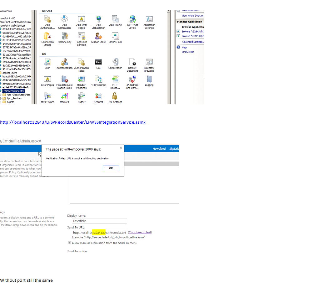

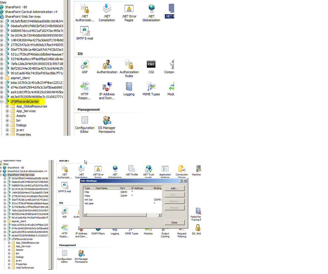

replied on December 21, 2014
Hi Alexander, thanks for the response. However I am not running on the default port as shown in the attached files with my screenshots. I have tried both with the port and without the port to no avail. So if there's anything else am missing. Let me know
replied on December 22, 2014
Are you able to browse to the web service URL in a web browser?
replied on December 23, 2014
When I browse with the port I get a blank page. Without a port  I get "The webpage cannot be found" error.
