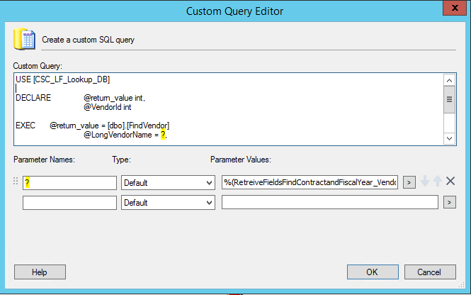

We have a custom query that runs a stored procedure. The stored procedure uses a token to do a search on a database, and then it inserts it into a "Results" table. The first the stored procedure does, however, is to delete all previous records inside that table. The problem is that after the stored procedure runs from workflow, it only deletes the records, but it doesn't add the results found. When we test the stored procedure on Management Studio, it works perfectly. We have tested it in workflow using the "Test" button on the Custom Query and manually typing in a test value we know works, but it still won't insert any results into the Results Table. This is how the custom query window looks like:

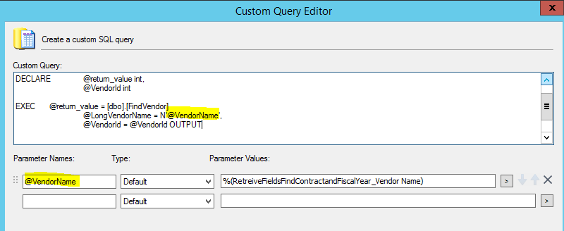

Without the "N", the stored procedure still runs, but it won't write any results on the table.  You have, however, pointed me towards the answer. I have updated my script to look like this:
And now it works perfectly! Thank you very much for taking me on the correct direction
